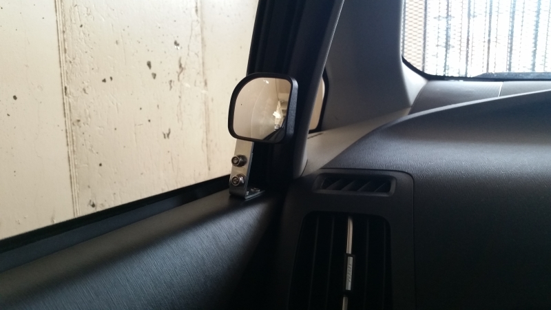

    If you're really ambitious, you can remove the passenger mirror; no state requires an external passenger mirror (except a handful that require it when the windows are tinted). My car hasn't had external mirrors since 2016, and my previous car since 2012; most states don't require one at all, including Oregon. I use these:
