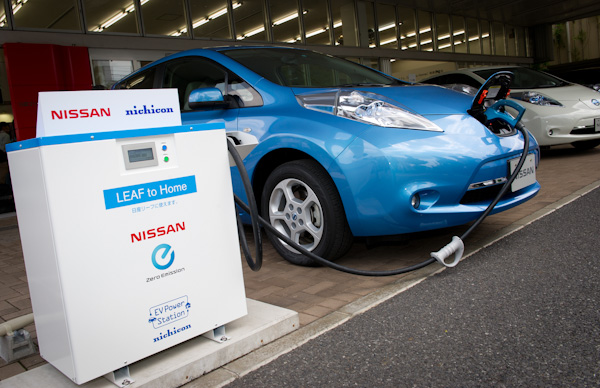

    ^Could be this?

    There was some photos in one of the threads of an orange adapter that allowed plugging an appliance into the Prime's charge port. I don't think such would meet the needs for emergency home power. It was powering a tea kettle at a picnic in the photos.
    I called the other device a 'backwards' EVSE because it can charge the car, and also transfer electricity from the car to power the home. They available in Japan, and might be available in California for use with the Mirai.

    CHAdeMO is, as far as I know, a fast DC charging type in which the charger is in the charging station and DC current is provided to the car bypassing its charger. Don't understand what this has to do with an AC outlet?
