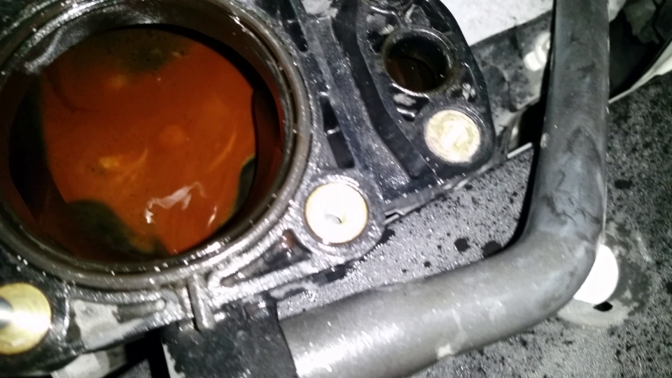

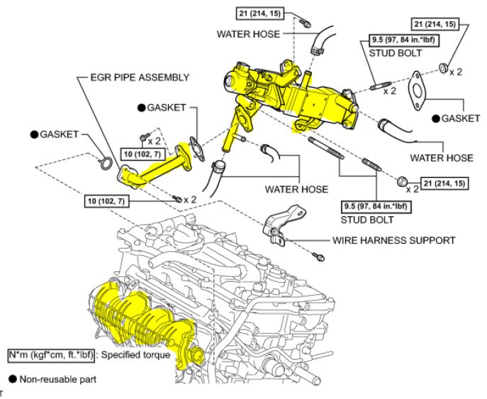

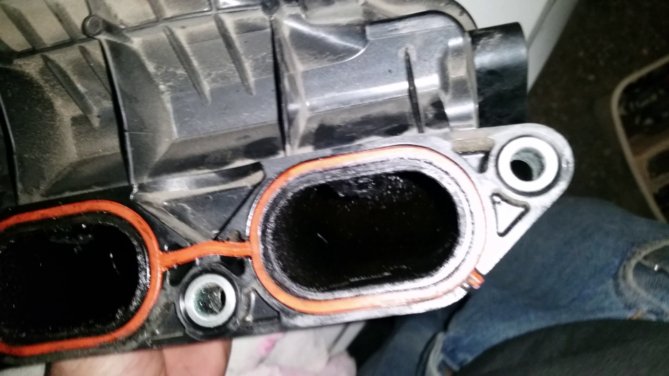

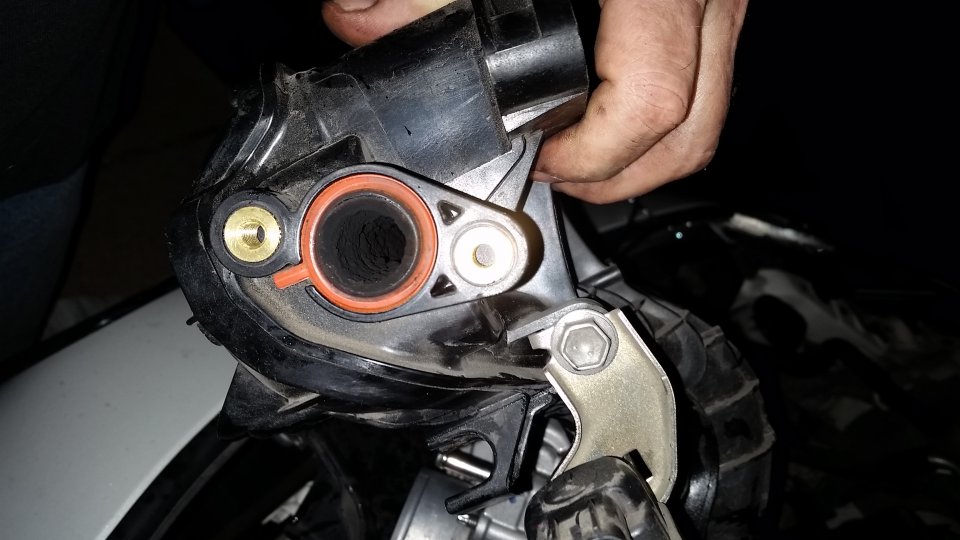

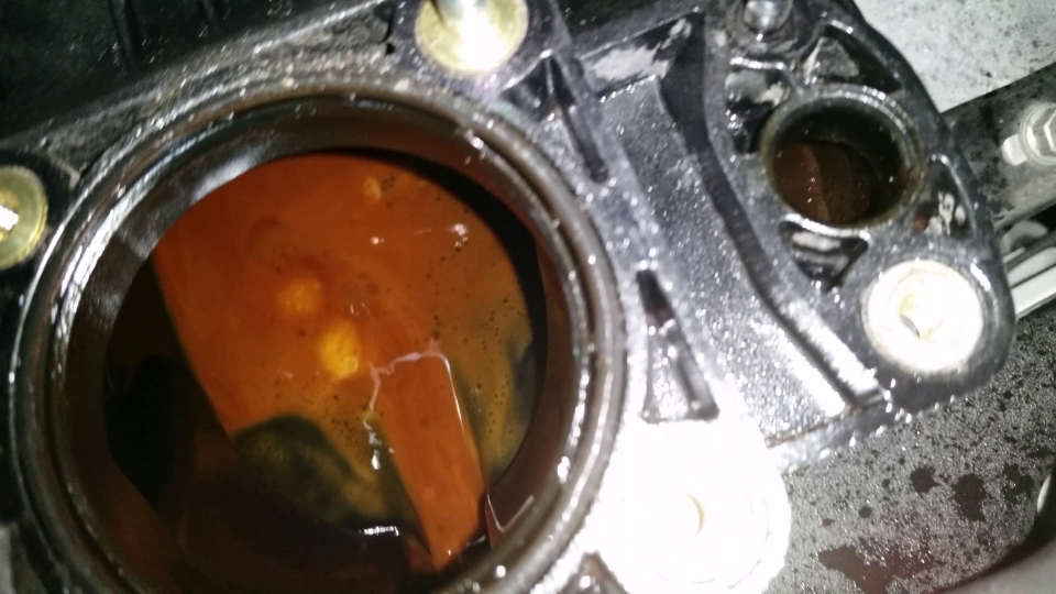

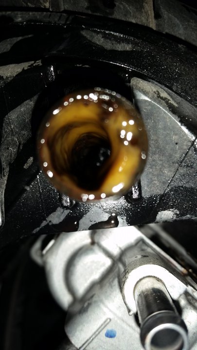

  16. DG Bear
    DG Bear Junior Member
    Jun 7, 2014
    85
    24
    plano, tx
    The cause and effect was like night and day (as others have mentioned). Before the cleaning... intermittent knocking which eventfully lead to a reoccurring P0304 code and shuddering under certain loads. It's also what a Toyota mechanic (not the front line customer server reps) told me when I demonstrated the problem and talked to them recently.
    At this point I'm not certain of the root cause... but many think its a design problem. Don't think overfilling of the engine oil is a part of this issue.
    The second 2010 Prius I did also had blockage in the tube that connects the throttle body into the engine block. It was full of a light colored heavy weight oily substance (like mixing engine oil with honey). Enclosed are some pictures... Prius.2 Gue.jpg is tube that goes to the engine block the others should be obvious.
    The picture Prius.2 Oil Concentrate under Throttle Body.png shows the oily substance in the intake manifold (under the throttle body). The picture was taken as I was shifting the throttle body around... the stuff was flowing backinto the main body of the intake manifold.
