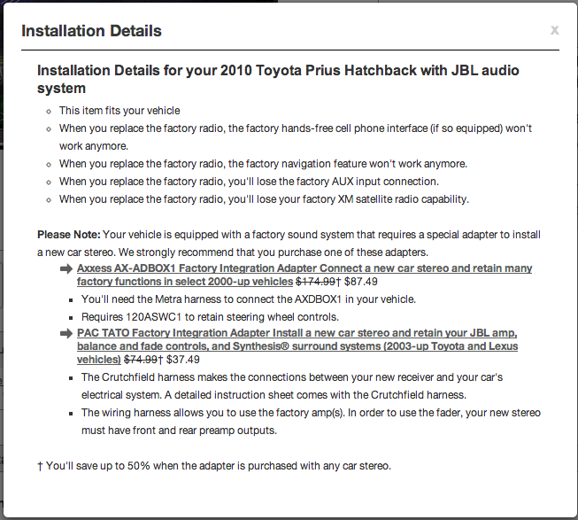

    I ended up with 2010 Prius Five today and just wondering what features are chained with navigation unit. In other words, what will break when I swap original navi unit with Pioneer?
    It have parking assistant and I believe it should broke. What else?

    Yep, head unit & backup camera were replaced.
    Pioneer could do better job. When their Carplay implementation works than it's beautiful. However, here are caveats:
    - significant time to boot
    - crappy license screen which you suppose to read & press OK EVERY SINGLE TIME when you connect your iPhone
    - sometimes it stopping working right in the middle & reboots itself
    I suggest you looking to Alpine models instead.

    Yes. Installer put a module which keep functionality of volume & track backward & forward buttons intact.
