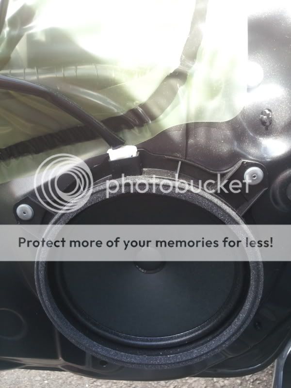

    can anyone confirm that the depth on the rear doors is the same as the depth on the front doors?
    i am asking because i took the rear speakers out today and test fit a 6.5" infinity kappa perfect speaker (2 5/8" top mount depth) from my old car and it did, indeed fit. i plan on getting the image dynamic ctx65cs 6.5" speakers (2 3/4" top mount depth), so i know that they will fit in the rear doors.
    if someone can please confirm that the depth are the same on all 4 doors, i won't have to remove the front door speakers until i'm ready to replace them. thanks!

    how do u remove the speaker like the stud ???

    2013 Prius c
    i drilled mine out

    what u use to screw it bak on ???did u made new holes ?? and one more question can u put any size magnet or it have to be small or have to get a adapter
  8. los panda
    los panda Member
    Jun 23, 2013
    155
    23
    2013 Prius c
    i don't plan on putting them back in, i installed spacers where the original speakers were; so i could fit huge aftermarket speakers.

    were did u buy ur spacer from
  10. los panda
    los panda Member
    Jun 23, 2013
    155
    23
    2013 Prius c
    i traced the stock speakers on cardboard.
    i found sellers on ebay who made mdf rings/spacers, i asked if they could make custom spacers for me. i chose the guy w the lowest price (i think it was $25-$30 for all 4?) so i mailed him the cardboard cutouts and he sent me back 4 spacers.
