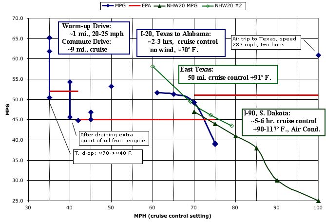

    We see the biggest difference when comparing the NHW11 versus NHW20:
    Notice how the NHW20 and NHW11 meet in the 65-70 mph range. But on either side, the NHW20 walks away due to better transaxle, engine, and control laws. Above 70 mph, the drag is so high the NHW11 engine begins to run 'fuel enrichment' mode.
    Here is another collection of NHW11 and NHW20 points:
    In 2006, there was a marathon Prius stunt where a team of drivers drove a Prius ~1,200 miles over several days. Their log are the black dots in chart. It was summer and they 'tuned' the Prius for optimum performance. In contrast, the "gray" line represents my best estimate of NHW11 performance, mph vs MPG. Various benchmarks show this line has merit. However, these are 'warmed up' data values. The NHW11 warm-up is a thing of horror but can be mitigated.
