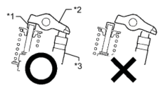

    From the repair manual:
    I think there's something wrong with this pic:
    Should the $2 item (valve rocker arm) on the right side be mirrored left/right?
    On n the next page, this picture seems more realistic:
    Blow-up of exhaust side:
    ^ the yellow-highlighted portion I believe is the ball bearing he notes in the video, saying it should be over the hydraulic adjuster.

  7. ChapmanF
    26,217
    17,172
    Pic looks OK to me. It's not showing two rocker arms facing each other. It's showing one rocker arm, and the right () and wrong () way to install it.
    The way, you can see, does not have its domed end securely sitting on the lash adjuster, so its valve end is barely even pushing on the valve. If installed that way, the rocker is probably not going to stay put.
