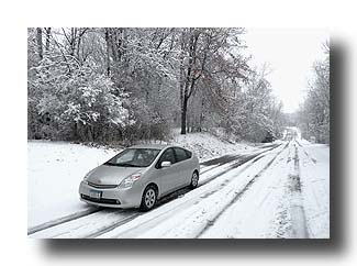

    5 winters with the 2004 in Minnesota were just fine with the high-traction all-season tires...
    ...and when my first set of HydroEdges needed replacement, it just happened to be March when we were getting dumped on with lots of snow. So, I got the opportunity to compare the very same tire with the difference between minimum tread and brand new. Depth of tread most definitely influences gripping power.
