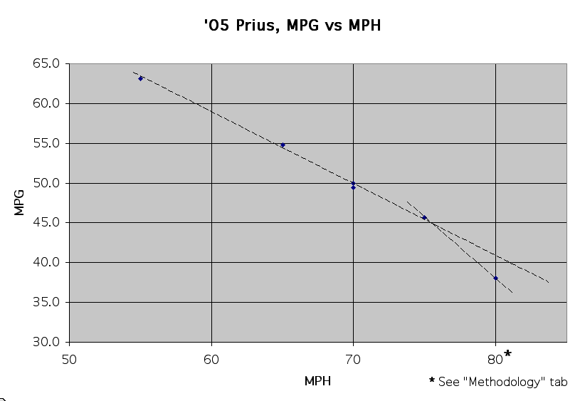

    I recently did some fuel efficiency and speedometer accuracy tests on my Prius, and wanted to share the results. I've attached a detailed explanation of my tests for anyone who might be interested, but consider this an "executive summary".
    Fuel Efficiency vs Speed: First, I wondered just how much of a hit you take in fuel efficiency the faster you drive. As with ALL cars, the faster you drive, the lower your MPG will go. However, since the Prius has significant advantages over a normal car at slower speeds, you will see a wider swing in MPG as you increase your speed. Still, at the fastest, a Prius is still more fuel efficient than a normal car, so you can speed and still save money. ;)
    All that said, I'm still a big fan of treating the speed limit as a "limit". As I did the higher side of these tests, I found myself getting caught up in the competitiveness of speed, and found myself yelling at people who got in my way. I forgot how relaxing it was to be passed, instead of working to pass others! :)
    "Very generally speaking", you will get roughly 1 MPG of change for each MPH you drive faster or slower than normal. If THAT doesn't encourage you to drive slower, nothing will. :)
    Remember to check out the attachment for my specific methodology, but here are the results in a nutshell: You get about 5 MPG better mileage by driving 65 instead of 70. You can get a whopping 13 extra MPG by driving 55! Of course if that isn't the truck speed in your state, that's too slow. You will lose at least 4 MPG by driving 75 instead of 70. And you will lose a whopping 12 MPG by driving only 10 miles per hour over at 80. Of course getting almost 40 MPG at 80 still ain't bad, but you can do so much better! :)
    My tests, my conditions (sorry about the formatting):
    MPH MPG CHANGE % CHANGE
    55 63.1 13.2 26%
    65 54.8 4.8 10%
    70 50.0 ref ref
    75 45.7 - 4.3 -9%
    80 38.1 -11.9 -24%
    Note I found almost a 17 MPG variation between 65 and 80. Wow. Go 65!!!
    Air Conditioner Hit: The A/C is electric, so there is no immediate drag on the engine. However, the energy pulled from the batteries has to be replaced, which means the car has to stop using the electric engine for part of the torque and use it instead as a generator to recharge the batteries. I found little difference in MPH on the leg out, but -4.6 MPG on the leg back. The round trip average between the two tests was between -2.4 and -2.9 MPG lower, so expect a hit of a few MPG when you use your A/C.
    Speedometer Tests: I was going to list these results in a separate thread, but I see little need. The results were good, and as expected. Accuracy varied more by what precise speed I chose to engage cruise than anything else. There were the usual variations due to hills and valleys, but generally speaking the speedometer was always within 1 digit of the actual speed, favoring the higher side, as the US mandates.
    Attached are all the specifics. You will need Excel. Tabs at the bottom of the page will lead you through the file. The chart will be the first thing up. For those who are Excel-challenged, I've also provided the chart in GIF format. Enjoy!!

    I would have expected fuel use to scale with the kinetic energy of air displaced, at least at the high velocity end. Therefore it's of interest to re-plot your data as fuel used as a function of velocity squared. Excluding the 55 mph data, the fit is OK...[attachmentid=693]

    Results look pretty reasonable for my car at around 80 degrees, except for some reason I get less at 55 mph. I don't see temperature listed, but the effect is big.
    My general rule is 55 in winter = mpg of 70 in summer, this from reading someones graph posted a year or so ago. Foget what temps I looked at but I think I figured summer at 80 degrees and winter at 10 or so.

    The temperature was listed in the methodology section of the spreadsheet. It was 68-73 degrees.

    You get better mileage at 70 mph than we get at any speed.
    I have not attempted to measure as precisely as you have, but just based on what the
    instrumentation shows at various speeds, our chart would look more like this:
    MPH MPG change difference from your results
    55 45 +3 +7% -18 -30%
    65 44 +3 +5% -11 -20%
    70 42 ref ref -8 -16%
    75 40 -2 -5% -6 -15%
    80 36 -6 -15% -2 -6%
    Tires at 41/40, temps around 65. No A/C or heat.
    2005 Prius II with about 5K miles on it. Built about a month before yours.
    Gas here contains 10% ethanol.
