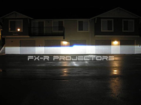

    Make sure to park about 25' from a wall and shine your headlights on it so you can get them level while you make adjustments. These lights as well as HIDs have a sharp cutoff line and misaligned headlights look goofy. :)
    This is a properly aligned cutoff.

    funny picture~! LoL
