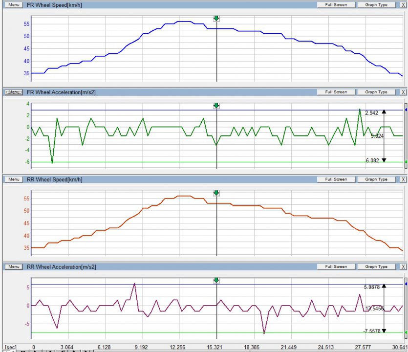

    I've checked your raw values, they do seem to flip between the min and max. I 've a log file captured by Techstream on a Gen3:
    The correct range seems to be small and centre around zero. Therefore, I suspect all your max. values are negative values. Please help to test the formula as below:

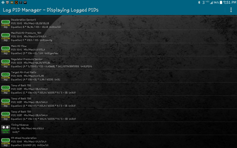

    I am attaching the results in a spreadsheet along with a screenshot to show the modified PID in Torque. This time it showed zeros and some weird characters occasionally. I also include FR Speed for reference. TorqueNewPID.png

    It is likely the SIGNED() function is not working. If that is the case, try this:
    Column 1
    0 [TH]Name[/TH][TH]ShortName[/TH][TH]ModeAndPID[/TH][TH]Equation[/TH][TH]Min Value[/TH][TH]Max Value[/TH][TH]Units[/TH][TH]Header[/TH]
    2 [TR][TD]FR Wheel Acceleration[/TD][TD1]FR WA[/TD1][TD1]2142[/TD1][TD1]( A - {A:7} * 256 ) * 199.27 / 127[/TD1][TD1]-10[/TD1][TD1]10[/TD1][TD1]m/s2[/TD1][TD1]7B0[/TD1][/TR]
    Vincent
  5. Cave Arnold
    Cave Arnold Member
    Apr 20, 2014
    64
    60
    Lehigh Valley, PA
    I think we have a winner. I need to try and correct the sign. I tried -( A - {A:7} * 256 ) * 199.27 / 127 on the way home and that did not seem to work. I will try ( A - {A:7} * 256 ) * -199.27 / 127 tomorrow and see how that works out. Thanks for your help.
