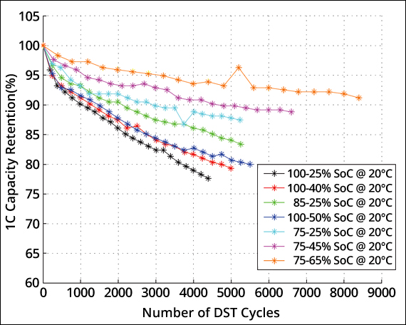

    That's based on charging to a float voltage of above 4.2V, and draining to zero (100% depth-of-discharge) like is common in cell phones.
    The Prime doesn't do that, as mmmodem told you above.
    Limiting the full-charge float voltage to something like 4.1V-4.15V and limiting the depth-of-discharge to around 15%-20% enormously enhances the longevity of Lithium batteries, up to a factor of 10-20 by some estimates, though a factor of something like 4 is more conservative.
    From: How to Prolong Lithium-based Batteries - Battery University
    Looking at it, I suspect the green curve is closest to the way a Prime full Ev charge cycle looks (85% - 25%). So, that means you'll loose 10% in 2,000 cycles (one cycle a day for 5 1/2 years) and 15% in 4,500 cycles (one cycle a day for over 12 years). Of course, all this is dependent on chemistry, temperature, duration held at full charge, and so forth.
