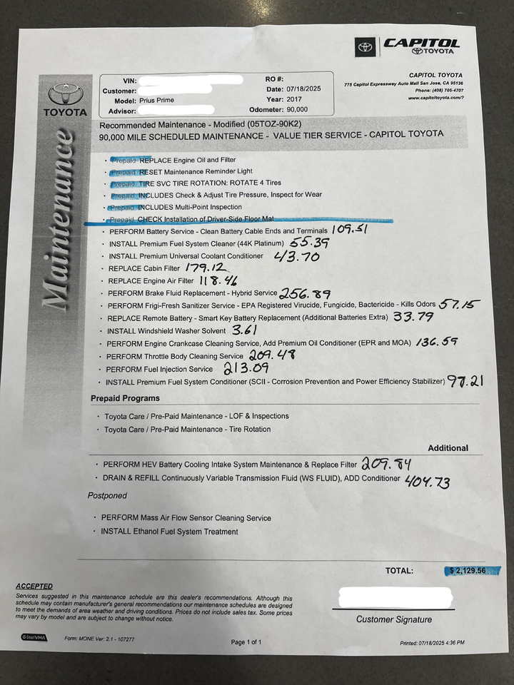

    The first one quote me for $2129.56, and this is after deducting my pre-pay package for oil change. I am attaching their quote here so you can see how they charge. However ridiculous it is, it is not where I have my issue. That is intelligence tax. I just politely tell them that I am only looking for what was recommended by Toyota, not dealer. So I need a update on the quote to show me basic things to do. and then they start to have problem with that. The advisor keeps refusing my request to provide me the quote and said that is all needed for 90K miles maintenance. After repeating my requests for more than a dozen time but still can't get a quote, I told him I can't work with somebody who failed to hear his customer so badly.

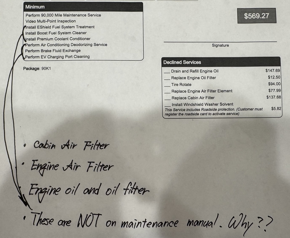

    and now it's the second dealership. I repeat the same request with same tone, try not to carry over my bad mood to the new advisor. He quoted me a price for $1044.95. He is however at least more cooperative and is willing to honor my request to drop these service that I don't really need them to do for me. Afterward the price becomes $569.27. Still rather high but at least he talked like a real customer servicer.

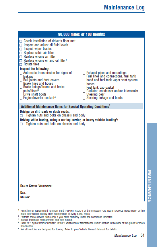

    So I took this latest list, get back home, and check Toyota maintenance guide, I attached the screenshot of what is said on the Toyota documentation. Now I get confused again about these weird items:
    • Install EShield Fuel System Treatment
    • Install Boost Fuel System Cleaner
    • Install Premium Coolant Conditioner
    • Perform Air Conditioning Deorderizing Service
    • Perform Brake Fluid Exchange
    • Perform EV Charging Port Cleaning
    All of a sudden the second friendlier dealership doesn't looked that trustworthy to me anymore. This is, according to the advisor, the minimal package for 90K miles service. I am not seeing it minimal at all and is that "EV charging port cleaning" really a thing or joke?

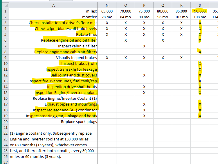

    Attached is a table format summary of the Toyota USA's maintenance schedule, as outlined in the Warranty and Maintenance booklet, for the Gen 4 Prius, and undoubtedly the same applies to the Plug-In variant..
    Here's what Toyota USA says to do:

    Thanks for sharing. I actually have a very similar list for my old cars and I started to create one for Prius just last night.

    The ONLY thing on that list that may need to get done is the brake fluid exchange. Other OEM's like Toyota Canada, and Honda specify 3yr or 30K to 6yr or 60K mile brake fluid changes. Brake fluid may be tested to see if it needs changing, but at 8yrs and 90K miles - I'd probably change it to be on the safe side. The Toyota OM does say check brake fluid, but doesn't state visual level check or chemical strip testing.
    The other thing that may need to get done is changing the ATF. While Toyota states that this is a lifetime fluid, my experience has been that going 90K-100K miles, that fluid is full of metal filings from wear and tear along with 90K miles worth of heat cycles. While these transmissions are resilient, swapping out the ATF around every 100K is cheap insurance vs a transmission failure. Around $200-$250 service.
    Those are the only two things I would deviate from the Toyota OM. This is from my experience fixing, maintaining, and flipping cars on the side; over the decades. Service advisors are paid on commission. I would've asked to speak to the lead service writer or owner of the dealership, if I was treated that way at your first dealership. You may also file a complaint with Toyota USA corporate too. They shouldn't have 'pushed' when you asked for ONLY written OM 90K maintenance be performed.

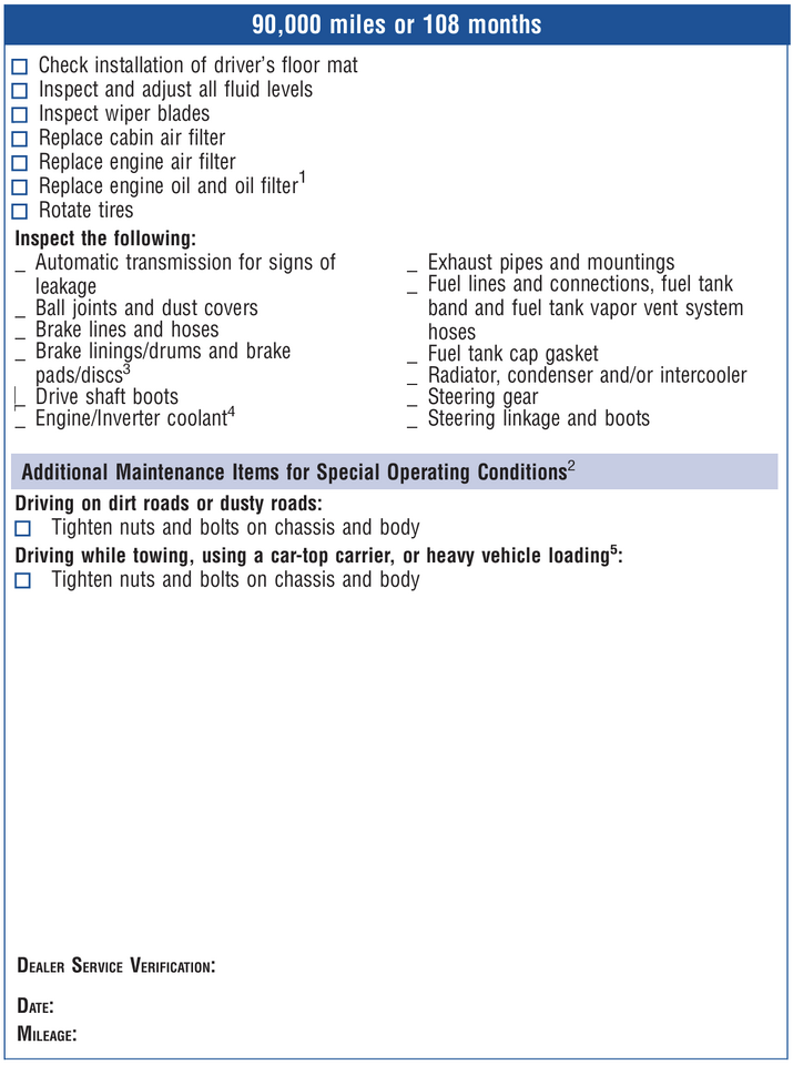

    The maintnenance is not in the "OM" (aka Owner's Manual). Again, the publication to mention is the "Warranty and Maintenance Booklet". If it's not at hand, a pdf can be downloaded, one source being the Toyota Tech Info site (just google), iunder the "Manuals" tab.
    Here's the 90k mile page:
    My 2 cents, much of the above is either nonsense or DIY territory. Also, I would not replace either engine or cabin filter unless warranted. The inspections of various mechanical components and fasteners are vague to the point of being impossible to perform, basically tacked-on by Toyota to avoid potential lawsuits.

    I found a nice video from Car Care Nut about the $209 "HV battery cooling intake system maintenance and filter replacement" is really about:
    This is the video to replace cabin air filter yourself:
    This is how engine air filter is replaced:
    Just these three super simple items that scammy dealer would ask for $210, $179, and $118 respectively. The part for these works are around $50 (from Toyota official part, not random cheap alternatives on Amazon/Ebay) The estimated time to finish is 30 minutes to be super generous. So that means the dealer is charging me $900 hourly rate for their labor.
    I think even the lawyer or brain surgeon doesn't have the audacity to ask for this hourly rate.
