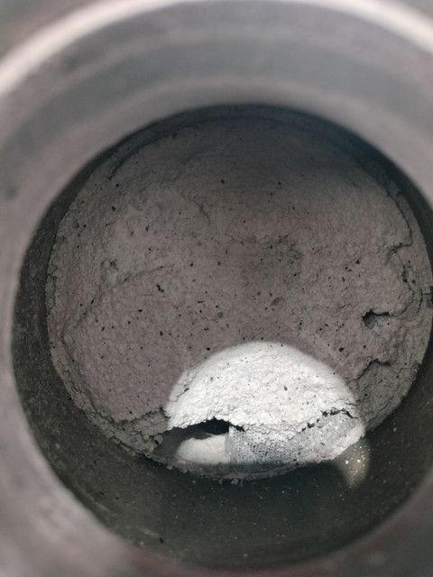

    I'd love to see photos of the inside of your cat

    Is that possible for me to do without removing it? Need some kind of snake cam?

    That thing is staying on until it gets stolen or the vinegar treatments stop working.
    If I end up replacing it, I'll take some pics for you.
