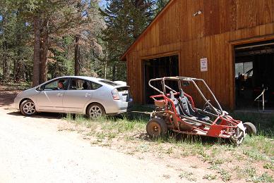

    I had to tow with my Prius before.
    I busted the front spindle of my go kart and had to pull it back up the hill. :(
