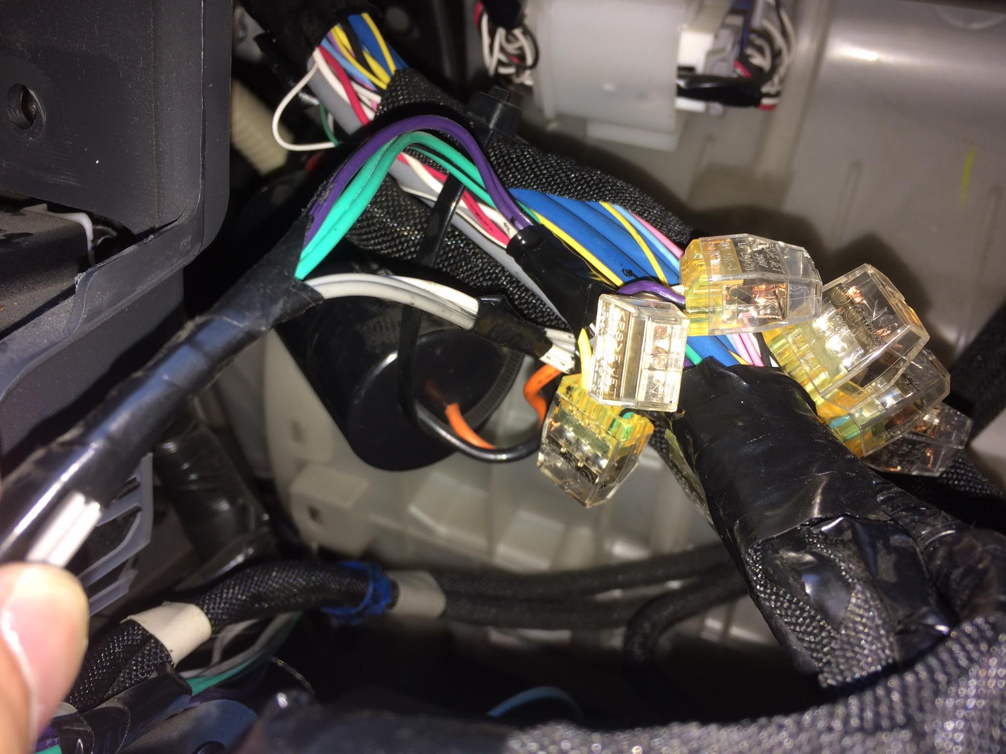

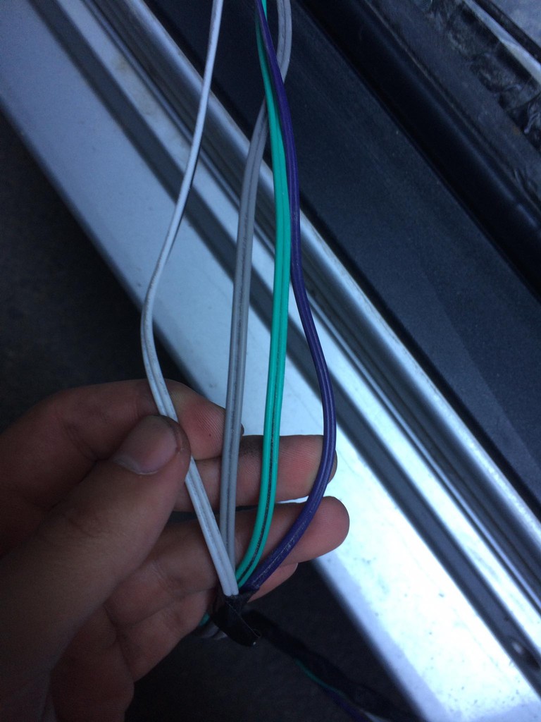

    So i found this cables, [​IMG]
    This cables go directly towards Factory Stereo, i have not dismantled it yet, but it think this were used for aftermarket Amplifier with Hi-Level Inputs (Rockford fosgate have such inputs on AMPS)
    So i have next questions: What is Factory Radio RMS Power-Max Power?
    What kind of Amp you Suggest for this kind of Speakers which i have written?
    I have feeling that this 4 speakers (Total 280 RMS-Max Peak 710) does not do even their half on this factory stock stereo.

    I would stay with a line level amp and those connectors are probably tied into the speaker lines. But it may be necessary to pull the head unit to verify. They don't look like enough wires for front and back unless there are separate aftermarket cables elsewhere. Its possible someone just amplified the rear which are known for weak factory output. Or tapped the front for amplification to the back.
    The attached file shows how to pull the unit.
    TheTewks and Tim Jones like this.

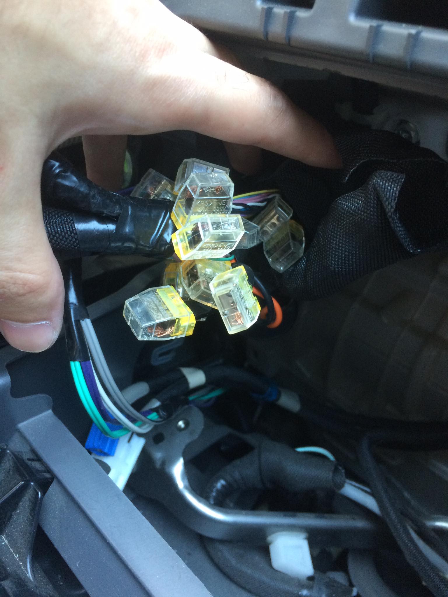

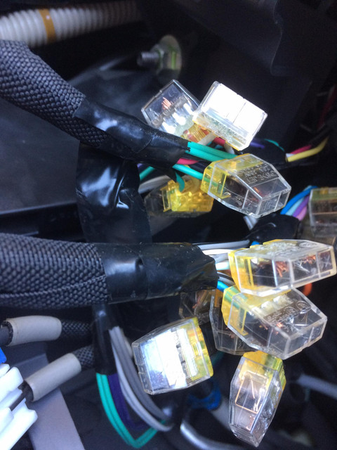

    i have dismantled the stereo system, and got this picture.
    Definitely something has been done here.....as i mentioned two pair of cables (front +- and rear +-) are connected to stereo cables, not directly but with some kind of modification to hear music from stereo even without amp.....i think i should show it to professional.

    An audio guy would easily figure it out. My guess is someone cut eight speaker wires at those splices and took the head unit side of each color to his amp and then brought the new amps output back to the speaker side of each color. When they sold the car they pulled their amp and simply spliced the original wires back together so that the head unit worked like factory. Or they could have used those splices to add a wire to each line which then went to an amp which was separately wired to new speakers. Its hard to actually see the wire end of those splices. CBDD1AF1-C41A-49F3-A384-ACB4BF40FF6E.jpeg
