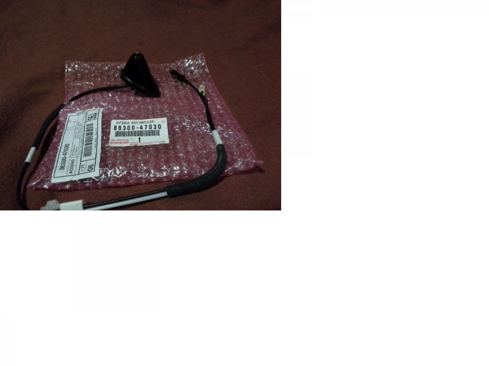

    If you had damaged the antenna base you would have cracked the circuit board inside. The antenna base is expensive, but easy to change out.
    I have one for sale, brand new.
    Toyota Prius Antenna. Part Number 86300-47030 Includes amplifier in the base.
    The amplifier is what makes it expensive. Whip antenna is NOT included. Fits Toyota Prius 2004 to 2009
    Brand New Toyota Prius Antenna. Part Number 86300-47030 Includes amplifier in the base. The amplifier is what makes it expensive. Whip antenna is NOT included. Fits Toyota Prius 2004 to 2009 Special price! $219.00 with free shipping. Save on the list price of $279.08 and save $60.80 Installation instructions are here at http://www.wallwatcher1 dot com/Antenna/
    My guarantee. If it doesn't work, send it back and I'll refund you $219.00
    You can pay by PayPal, send $219.00 to [email protected]
    Please include your address & Phone #
    Thanks, Lee (231) 773-9231
