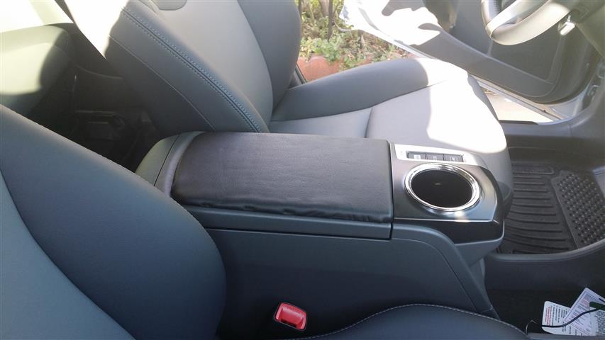

    I went to a local auto upholstery shop, and asked about the center arm rest. Long story short, for $30, they were able to cover it with leather, and fix one of the biggest interior annoyances I had about the car. Here's how it came out:
    I'm pretty happy with the result. They covered over the old fabric, and added just a little extra padding. Bottom line is, don't be afraid to go have this looked at. It was cheap to do, came out pretty nice, and took about 30 minutes to have done.

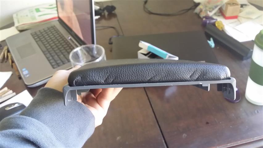

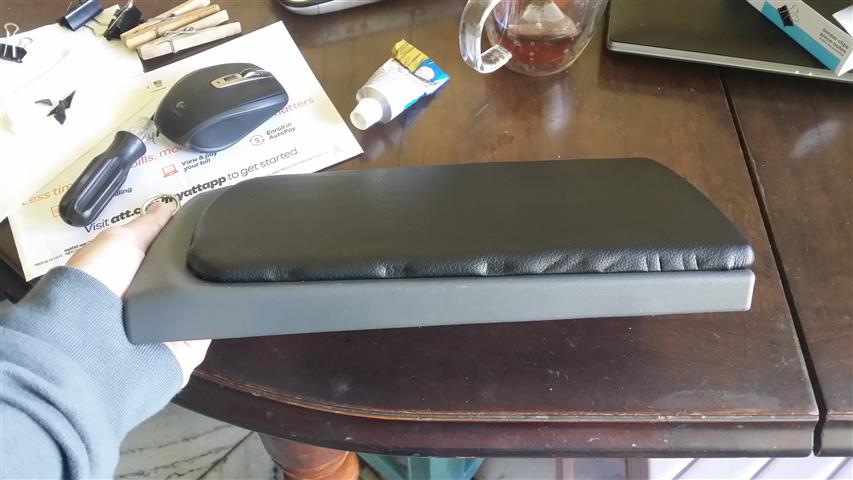

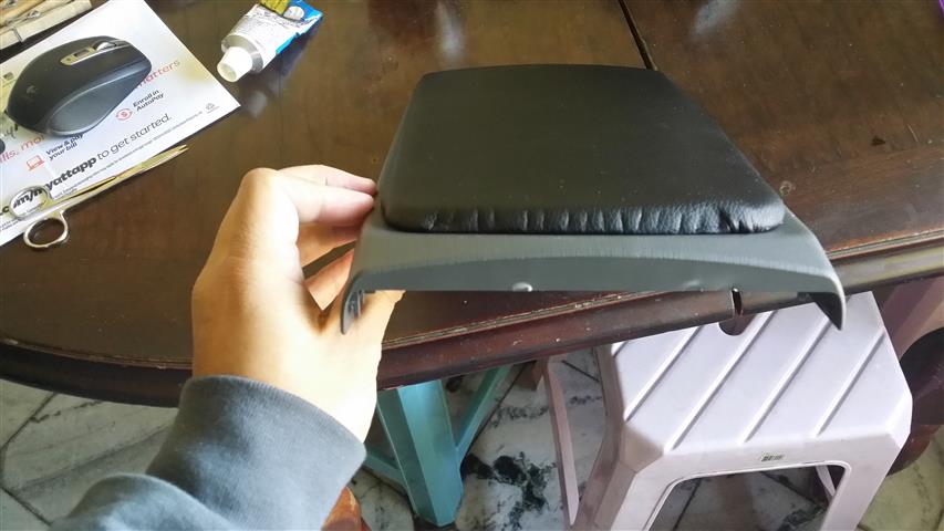

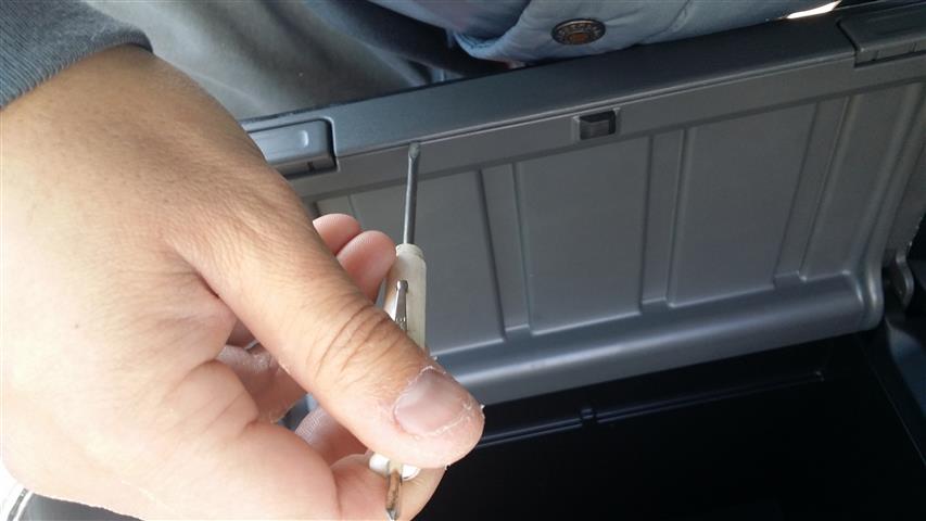

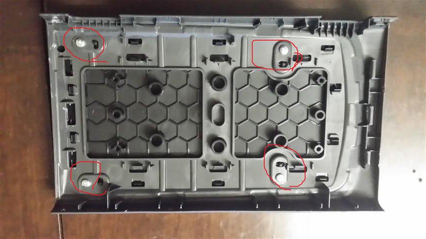

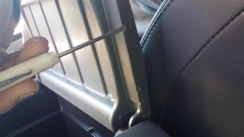

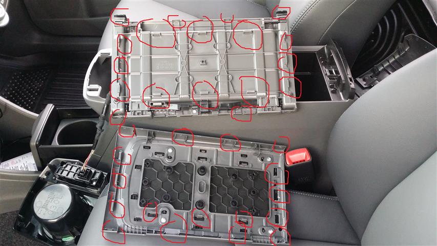

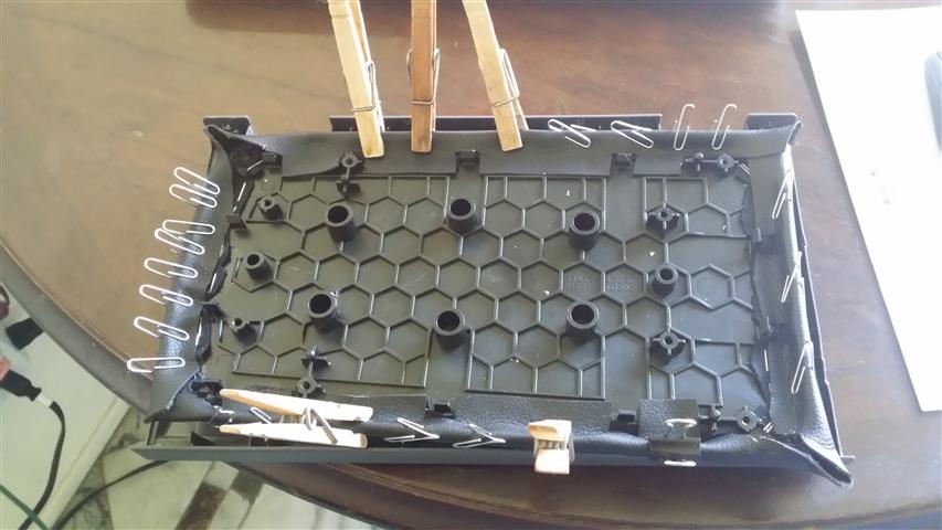

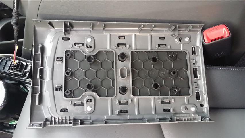

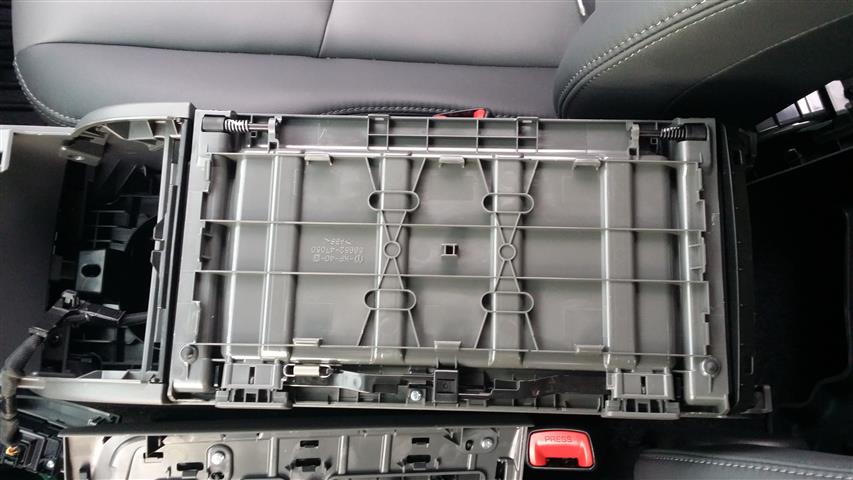

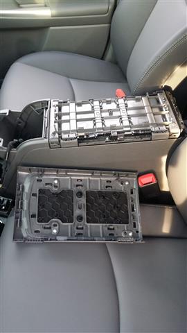

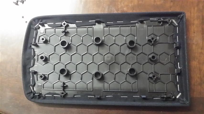

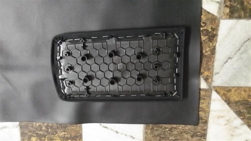

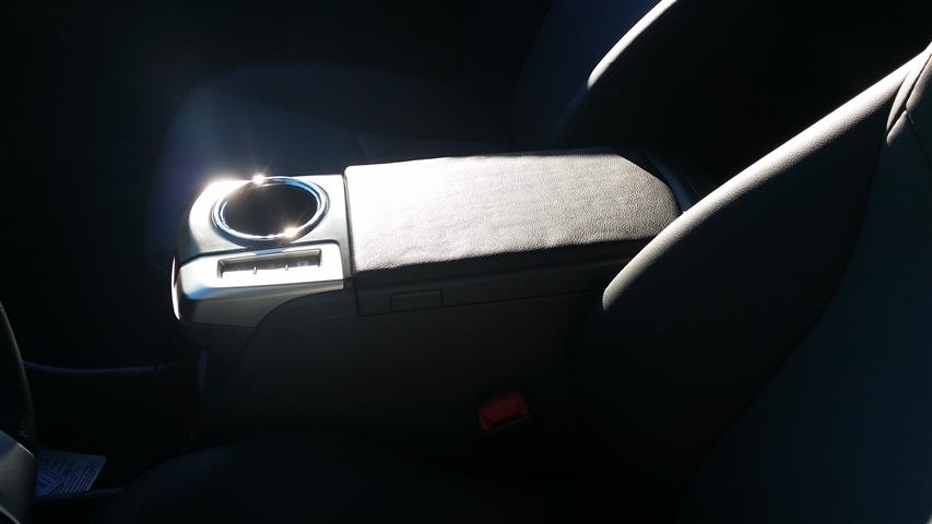

    I did the arm mod myself.
    It was a little hard taking off the arm rest panel and I damaged it a little. See pics below. I did removed the whole console door, which you don't have to, just leave on and pry off the panel. I marked off where the tabs are. There is another pic, where I circled off, those are screws to take the fabric panel off.
    This mod cost:
    Bought in downtown LA fashion district: Fake leather material $8 for 54"x36", but only used 14"x9". If you like to buy my left over, PM, and I can sell you 14"x9" for $6 including shipping within US.
    Walmart fabric glue: $4
    Total cost about $14
    If I were to repeat, take off the original fabric on the arm rest. Spread glue out more evenly.

    Was the original material attached with staples?
  18. Boston Jim
    Boston Jim Active Member
    Jun 28, 2012
    202
    148
    Pulled the arm rest apart thanks to the pictures from @RichardY with no damage. I took it over and had it recovered then put all the clips back on and reattached it with no problems. Then I found the four screws used to secure the top sitting next to me on the couch - doh! But I was able to easily pull it apart in 30 sec attach screws and pop it back into place. Not the best picture, but I'm happy with the results.
    (and yes the top has staples holding it in place)

    yes it just staples.
