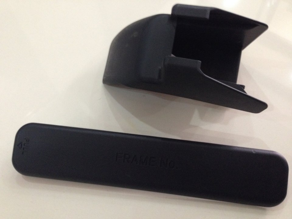

    there two parts were inside glove box when it arrived from JAPAN.
    Can any body tell if they are from the same vehicle ?
    one has a number as well.
    regards IMG_7520.JPG View attachment 74530

    Bottom piece labeled "FRAME NO." fits below the carpet, ahead of the front right seat track, covering an aperture that shows the VIN stamped on the frame.
    Top piece, not sure, but may be the cover from the back of a seat track.

    about the bigger piece , i tried but doesn't fit the small one fit where you mentioned .

    Top piece looks like a cap for a track, IE your seat track.
    Bottom piece looks like what Air_Boss mention, under front passenger see VIN cover thing....
    ahmad ashfaq likes this.

    I had the same issue, your right RichardY, backseat track cover.
