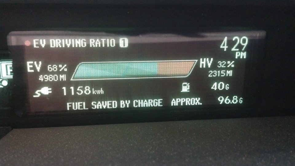

  18. JohnSNY
    JohnSNY Member
    Oct 29, 2012
    36
    26
    Long Island, NY
    I drive on average just over 20 miles a day in EV only. Because I am located on Long Island, I save about $30.00 each month by using electricity (using $4.00 per gallon for gas for comparison to a regular Prius). This amount accounts for the cost of electricity. Based on the U.S. average, I would save around $60.00 per month.
    In that same eight months, by having a PiP, I have not burned 96.8 gallons of gas that a regular Prius would have consumed.
    I have driven 7295 miles which amounts to 182.38 MPG. Based on a 10.6 gallon tank, my range has been 1,933.18 miles per tank. Prius Display 8 months.jpg Prius Display 8 months.jpg
  19. usbseawolf2000
    usbseawolf2000 HSD PhD
    Sep 22, 2004
    2,997
    Fort Lee, NJ
    You used 1,158 kWh (1,362 kWh with 15% charging loss added) of electricity for not using 96.8 gallons of gas.
    33.7 kWh is equivalent to a gallon of gas. So, 1,362 kWh is equivalent to 40.4 gallon of gas. Yet you saved 96.8 gallons. That's a good trade!
