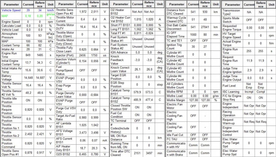

    For the OP ... it would be handy to have Techstream, and to do some logging of engine data on your test drive, including the difficult hill ... especially if you'd be able to get access to a working Prius v and take it around the same course logging the same things ... rpm, MAF, fuel injection, ignition advance, cam advance, etc.
    Here's an example from another recent thread.
