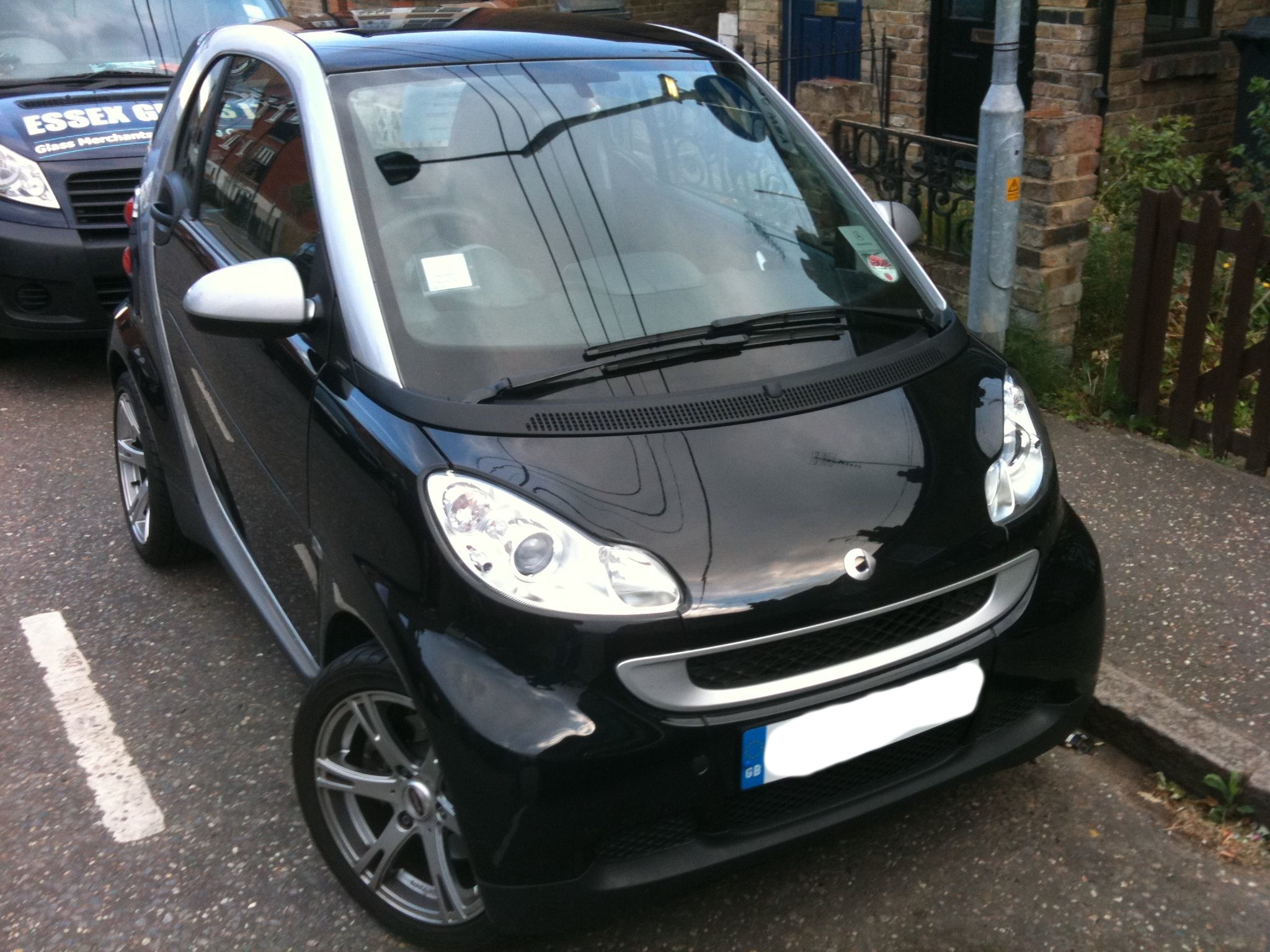

    i thought that was smartkey,not smartcar.
    the only smartcar i know is this:
    CR94 likes this.
  12. Mendel Leisk
    Mendel Leisk Sand Pounder
    46,042
    32,885
    Friendly, I bet a lot of readers where scratching their heads over that, just thinking "whatever". :)

    prius is 'a' smart car, not 'the' smart car. non sks is dumb.:cool:
