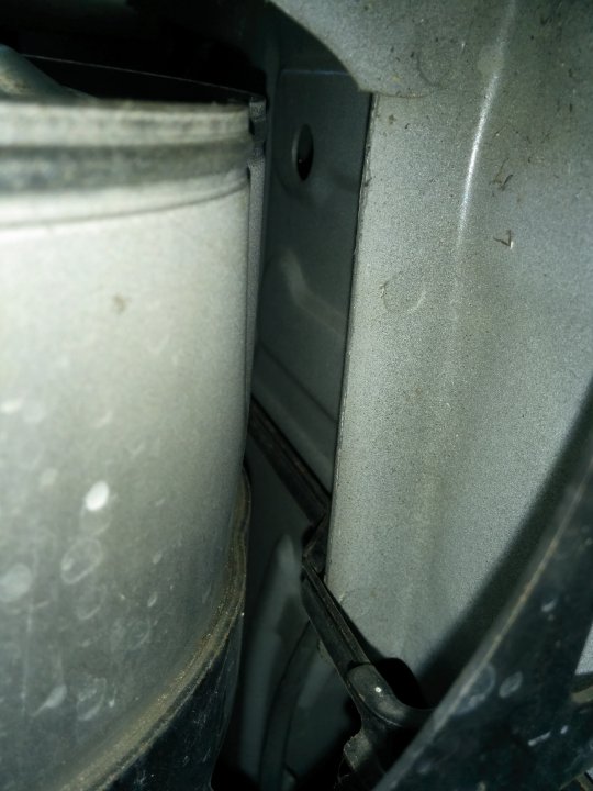

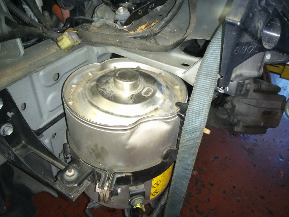

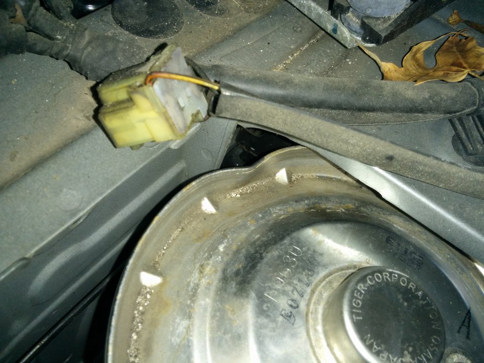

    Just got back from the shop. It is a Toyota dealer's service department. The mechanic showed me the dents and had a computer hooked up that was monitoring the valves opening/closing and the temperatures. I wish I would have written the numbers down as I can't remember what they were now.
    The only error code that was getting thrown was P1151 and I believe he said that was clear as they emptied the tank of air which was not done at Shop A, he said. I did make sure to ask whether or not it had a leak and he said no, it was holding pressure fine, and that he would put the car back together and see how it drives if he was me. So, I'm going to take that advice and see how it goes. He said the problem alert I was getting should be gone as it was probably due to the air in the tank, and that the heater also works now.
    I took some pictures of the tank which shows the dents which I'll post as well.
    First picture is standing facing the front of the car from the driver's side.
    This picture shows the dent in the back of the tank caused by impact to the front.
    The below picture is from the back side of the tank.

    Clearly the CHRS tank is damaged. Frankly, it should have been replaced when the car was repaired after the accident. But things like this do happen and it is unfortunate that your Prius is in the condition it is.
    It sounds like they have the air out of it now since the heater is working.
    As long as the three way valve is working properly and the thermostat is opening along with the water pump pumping and no leaks anywhere I would think you would be Ok.
    It would be nice if you could get the insurance company to cough up the money for the tank, but I would bet they won't do it.
    Should the tank be changed? I think that answer is only if the tank is leaking or not working properly. All it does it store hot coolant for the next start up cycle to speed up the engine warming cycle. Only the US models have the tank. The UK models do not.
