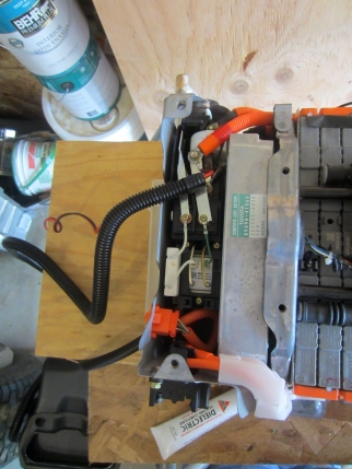

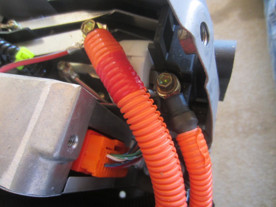

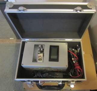

    There is a way for you to charge the HV Traction battery if it's run down without a lot of hassle. I can't say it's cheap; it's called a grid charger. I purchased mine from Raj at: Venice Hybrid Tech. The cost was about $285. I also purchased two harness, one for each of my 2002 Prii. I will be purchasing a 3rd harness for my 2005.
    The wiring harness is connected to the HV Traction Battery as I've shown in the attached pictures and the harness is led out to the trunk area. I'm still trying to figure out a good way to mount it high up in the trunk where it's out of the way yet easily reached by the charger.
    Did I need this? I wasn't sure. One of the Prii I've been working on has sat with an error for about 6 months. I've started it once in a while to see if it would clear the error (a P3009... ), so the battery charge never really flattened out. I felt I'd best be prepared to grid charge the battery and have the means to do it. It's always less expensive than taking it to a dealer. With three of these cars it's better to have than need than need and not have.
    Oh, I did add the box (Harbor Freight Part Number: 69316 and the split loom wire covering from NAPA. I've suggested to Raj that these items be included with the charger. I like having the charger protected when not in use and the wiring harness be protected from being rubbed or crushed if it's in the luggage area. But for now, the charger is sold without these items.
