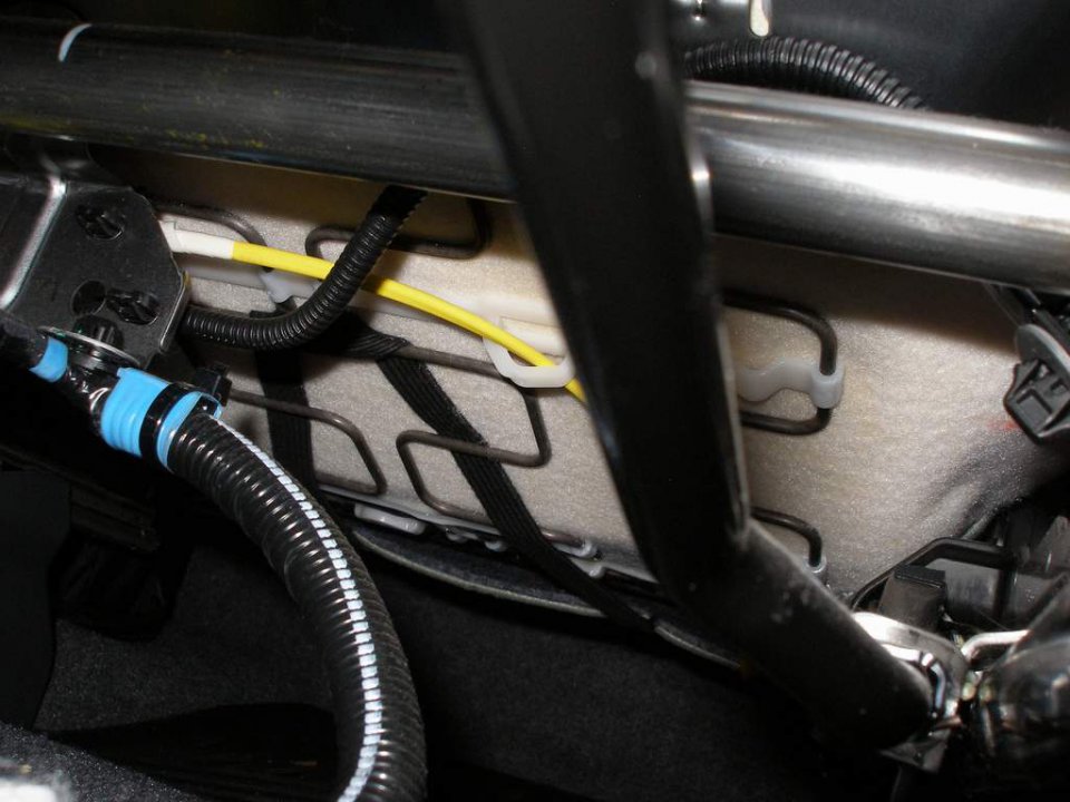

    Here's the seatback flap that completely blocks the crevice between seat bottom and back:

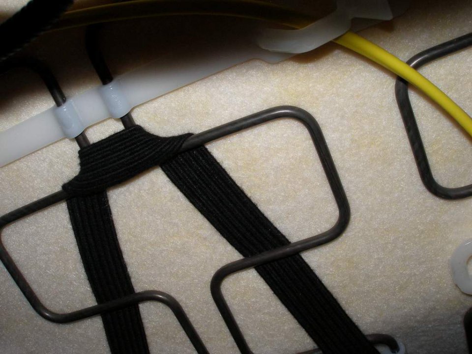

    Clazzio is telling me you must release the flap to install the covers, but look how the strap is one piece, looped around the rods:

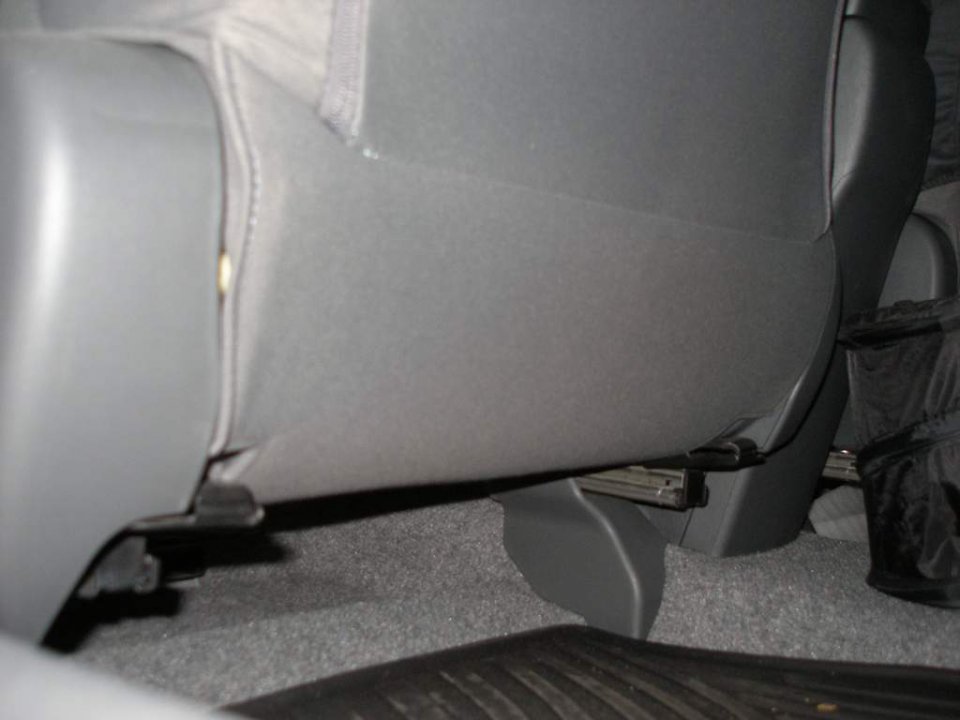

    See the flap and black strap under driver's seat: camera 552.jpg

    Yes.. you unhook the straps that are holding the flap down, on the seat back. Then you fold the whole piece up towards the pocket on the back of the seat. When you slide the clazzio cover over the seat, you'll slide it right over the flap that you have folded up. Then the clazzio cover gives you a new flap that you hook under the seat. It's VERY easy.. Prius is my favorite car to install.. with 2 people you can be done in 1 hour.

    That strap just unhooks from both sides. Loop it over one end and then the other.
