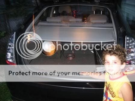

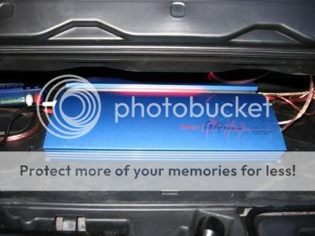

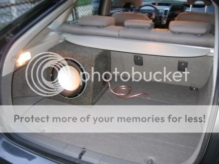

    Thanks, everything worked out great, I will post a few pictures of my small simple single subwoofer system later if I can remember when I get home. Sounds pretty good definitely was the kick that I was missing. By the way when I had the rear door panels off to trace back the speaker wire, I couldn't help but notice that the rear door speakers SUCK.... They are the equivalent of the $4 single speakers they sell in Target and Wal Mart, naturally I assume the front door speakers are equally as bad. So add that to the list as next. Does anyone have any suggestions for replacement rear door speakers that fit easily.
  9. morpheusx
    morpheusx Professor Chaos
    Mar 6, 2007
    1,555
    81
    Akron, OH
    here are the pictures, definitely Factory Door speakers are next.
