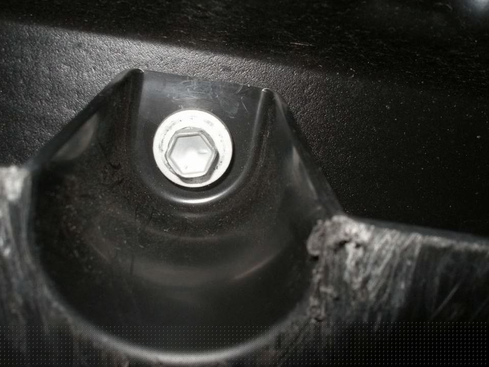

    Oh snaps, found a loose fastener / washer holding part of plastic cover right underneath lower front bumper, but several turns and tightening didn't fix thee rattle. Notice scrape on plastic piece. I've touched down a bit out of driveways, but my salesguy really scraped it the day I bought the car. Probably what started loosening this fastener.
    anyhoo, still looking although I don't have ramps.
    can't tell fastener / washer is loose in photo, but it was.

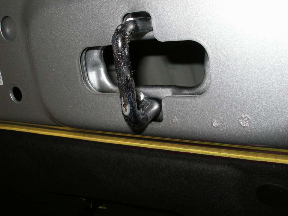

    Rattle fixed at Piercey Toyota this morning. They got right on it after check in, focused on several spots, but they were pretty sure hood latch / bar was main culprit, so they lubed it up and adjusted rubber supports for the hood. Thanks Ron :)
