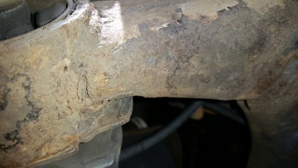

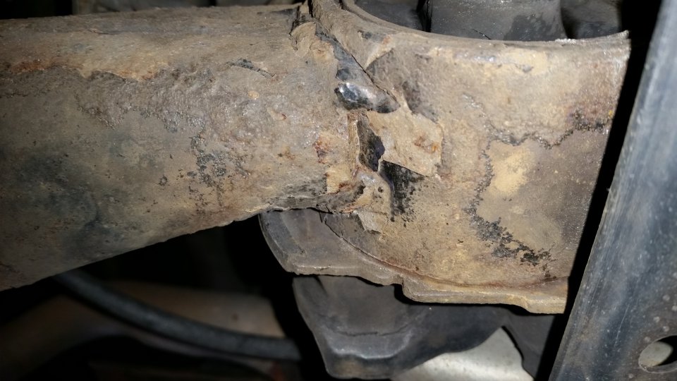

    Hello,
    Just hit 225k with my 2004 Prius about a week ago. I passed inspection without replacing the (slightly) cracked rubber bushings for now, but what worries me is the cracks and a slight hole (it has not rusted completely through, thankfully). Pictures attached. Should I do anything about this, and if so what?
    Also, I've noticed that when I let go of the brake pedal, especially after a medium to hard stop, I hear a squeaking... what's the cause for that? I know the front rotors have a bit of rust on the edges, but not sure if that's the cause... it seems to come from the back.
    Other than that, the only other noise I've noticed is a slight clacking/tapping when the A/C is on, usually in hotter weather. Only thing I needed to pass inspection was to replace the muffler after a year and 1/2 ago, the last non-OEM part they put in at another shop was junk and rusted through pretty badly leaving a hole that was leaking. Ended up getting it replaced at the dealer with the OEM part this time...

    Any competent welder could fix that but it may need removing to weld. Having removed the axle it would probably be quicker and cheaper to replace it with one from a front end damaged vehicle having obtained the part first.
    The replacement axle should be scrubbed down and given a few coats of paint to avoid the problem again.

    In structural engineering terms, this form of metal fatigue is called "stress corrosion cracking."
    The heat generated in the original weld crystalized and modified the metal on each side of the weld.
    Repeated flexing opened up microscopic cracks in the metal adjacent to the weld area, allowing water with other corrosive salts to enter.
    Corrosion continues and will eventually cause the area to break off.
    Those who have claimed that "rustproofing is NOT needed" should take heed.
    From the looks of the photo, this car has had a hard life in an area with the profuse of road salt and other debris with little attention paid to cleaning of the undercarriage.
    The only safe and permanent repair is a complete replacement.
    Otherwise, the axle will eventually break when placed under stress on the road.
    It is an accident waiting to happen.
    Repair it NOW or have it break on the road to have it towed in to the shop, hoping you don't have an accident in the process.

    Unfortunately, it is THAT dangerous. If it was an airplane, it would be grounded.
    The state inspection is NOT comprehensive and is only to check basic systems on the car and rust penetration.
    In you case, it is an accident waiting to happen. It is fortunate that it has been found. More often than not, it is found after the part fails,
    I don't know how old you are, but your life or the life of anyone you affect is not worth a couple of thousand dollars.

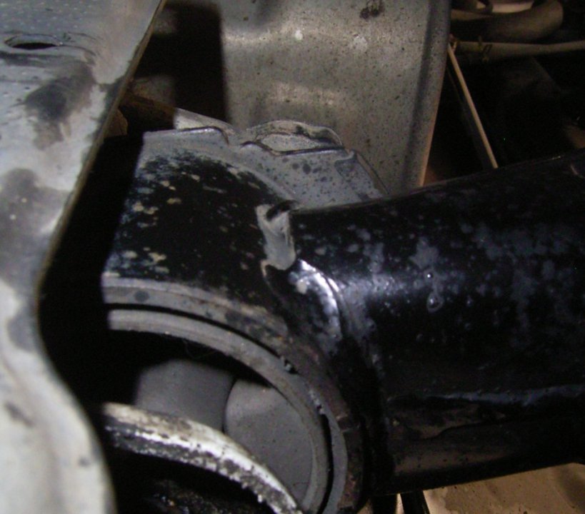

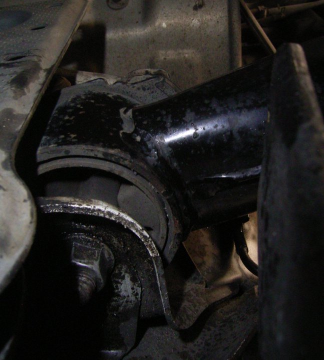

    I just crawled under mine to take a few pics. I gave it one quick wipe with a rag and could still see the original black finish intact.
    This is a 2004/2005 model (built Dec 2004). It's lived it's whole life less than 1km from the Pacific Ocean.
    Wow what a difference salt on the roads must make. It clearly trumps hot humid and being near the ocean when it comes to underbody corrosion!

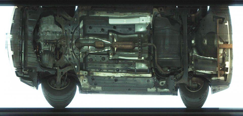

    Not the best resolution, but I attached a picture of how the undercarriage looked last year in July -- I worked an internship at a company that makes a vehicle imaging system. The rusted hitch was taken out, sandblasted and repainted and put back in a few weeks ago.
    I'll look for a place that can inspect the suspension sometime this week and go from there. Any particular reason you say to avoid the dealer (besides markup)? I don't mind spending the money to fix this given the safety issue, but at this point in time a new car just isn't something that's in the budget with a grad student salary. For anyone else that missed it, the car lives in the northeastern US, (MA/NH) so yes, they do salt roads a lot here during the winter.
