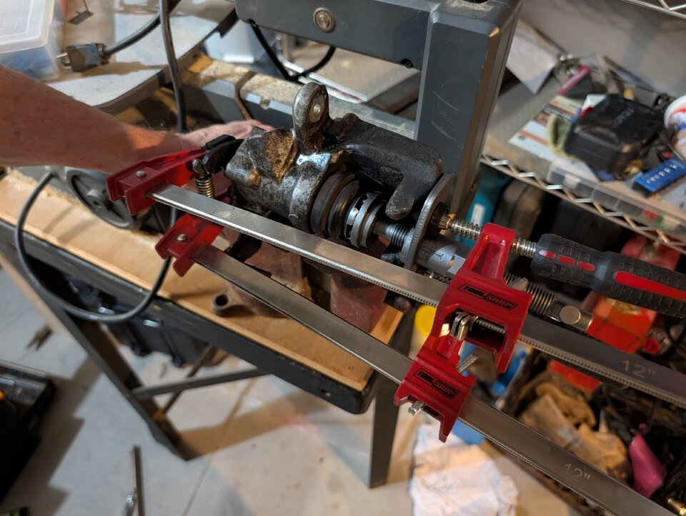

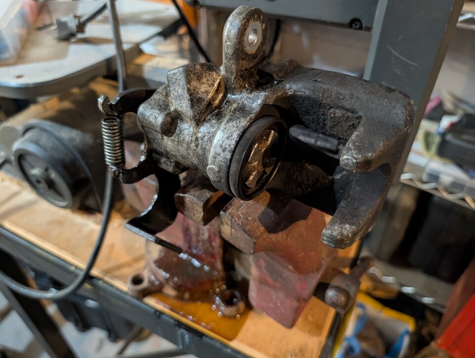

    Today's Update:
    I took off the caliper and put it in a bench vice just because I was having difficulty getting leverage. I rented the tool from AutoZone where it compresses the piston as it spins it. Because I had inadvertently backed the piston out further yesterday, I had to use the tool in some creative and unintended ways until I had the clearance to use the tool as intended. See pictures. Using that tool, I was able to get the piston all the way in. It gushed brake fluid from the fluid inlet as I depressed it.
    I haven't installed it back into the vehicle yet because it was getting late, but I plan to test it quite a bit to make sure the piston is behaving properly. I was really hoping I could take it apart and see the inner workings, but I didn't want to go down that road this time around when I had gotten it to depress successfully. My working model is still that there is some designed slip in the screw mechanism, and this was somehow seized or stiff. Obviously it's not completely fixed because it never unscrews when the piston is pushed out. Maybe one of you understands something about the inner workings that nullifies this idea.

    The sliding pin chambers are in the caliper mounting bracket, not the caliper.
    looking at that last pic, with piston fully in, is the rubber bellow around the piston partially prolapsed?
