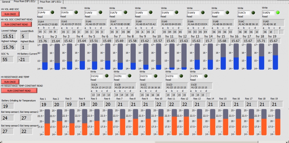

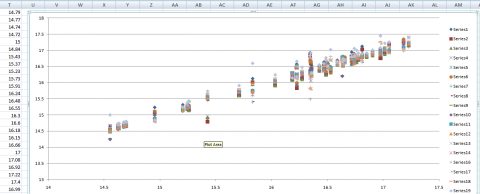

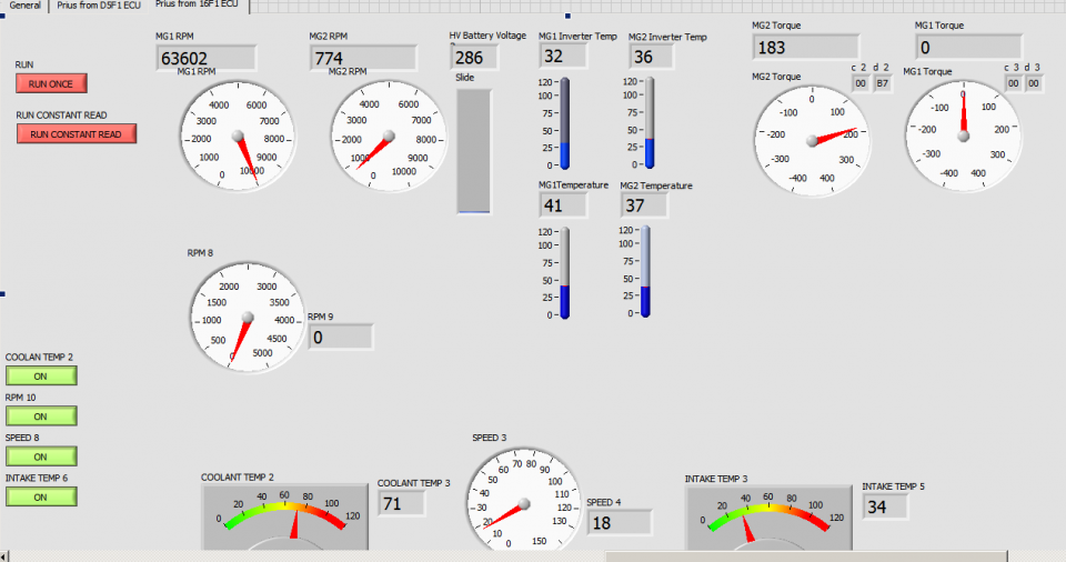

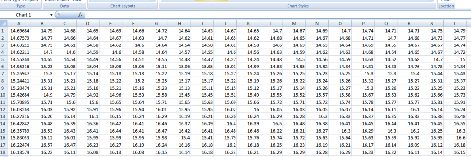

    I am in the middle of writing diagnostic software for the gen 1 prius, so I can monitor the 19 blocks behavior on all the SOC range, it can constantly write the results to csv file, and I can get the attached graph, it's not ready yet, but I would like to show you the voltages from all the blocks and MG1 MG2 temperatures, right after the "check engine" and triangle appeared today, so you can tell me if you think that it's something wrong with the hybrid system? would you drive the car normally after such thing happened? now there are no DTC to read so I don't know if the dealer can read anything.

    I'd suggest you take a close look at the state of your 12v battery. I had similar issues - the error screen without the expected DTCs. That led me to take a close look at the 12v battery performance, specifically the "at rest" prestart voltage, which was low (<11v). Replaced the battery and all is good now - in fact there was some roughness at cold startup that seems to have disappeared as well, and my remote opener now works from about 3x the distance.
