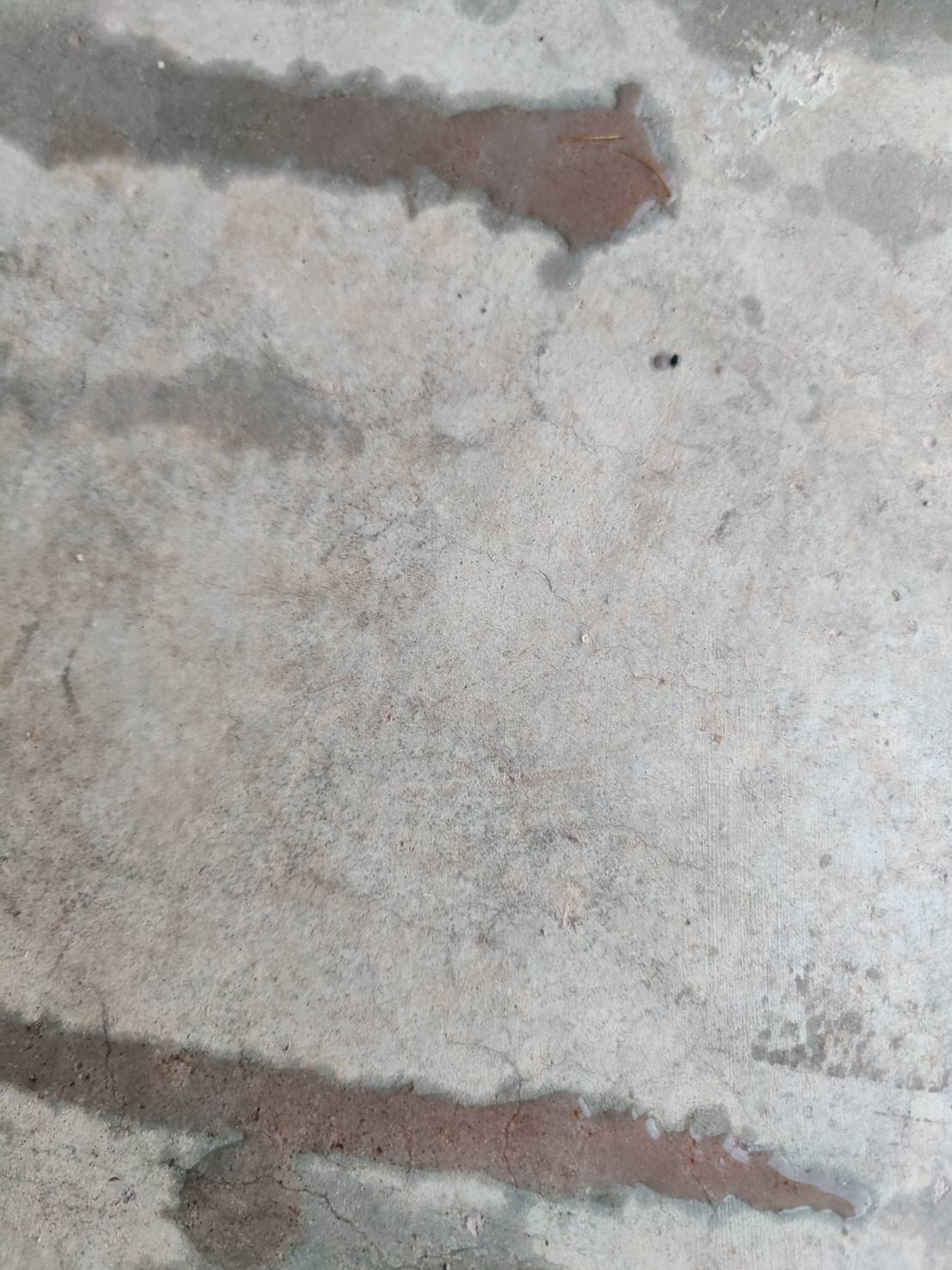

    Here's what the reddish fluid looks like. When I felt it, it was not oily or greasy or thick at all - it felt pretty much like water. (There are two streaks only because I don't always park in the exact same place in the garage.)

    Coolant I'd be tempted to look at coolant hoses to and from nipples on inverter and it's pump the lines cross over the trans n engine front and could be dripping. Either jug of coolant could show low or lower than before . If known were it was.

    Check the coolant levels - both in the radiator itself, and in the inverter reservoir. Top it up before driving the car any further. If it leaks a bunch, consider getting a tow to the mechanic's shop, as overheating the engine can damage it.
