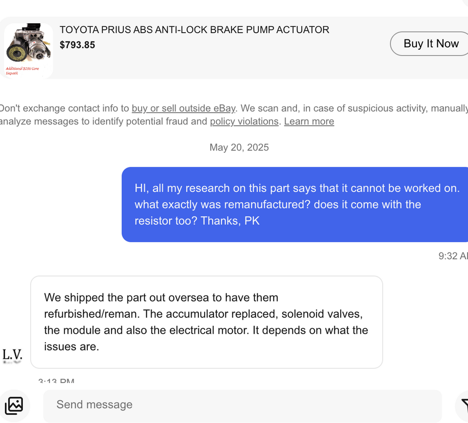

    seller on ebay states that they send out abs units to be refurbished. heres a screenshot of the ebay convo. could this be BS or the real deal?

    I guess if the eBay guarantee or whatever nonsense in force maybe. Seems highly unlikely but it should be able to be done other. Other similar a bit newer are 170 rebuilt . Like Corolla fenderwell mounted lotta lines .

    It'd be fun for us if you or someone else bought one and did an in-depth investigation... Refurbishing these has yet to be proven, but there have been rumors of people trying. The more you can tell us about this operation the better.

    Ebay sellers often say refurbished or rebuilt when all they have is used. Many may work if they were functional when the donor car was junked or parted out but even those won't last long compared to new oem.
    If they fail on install the seller will refund if you ship back but savvy sellers have a provision of no refund of shipping. So you end up paying shipping both ways and getting a % of your purchase back.
    Truly scam sellers will use this trick combined with a low item price and vastly inflated shipping costs. In those cases they still make a profit even if you return it.

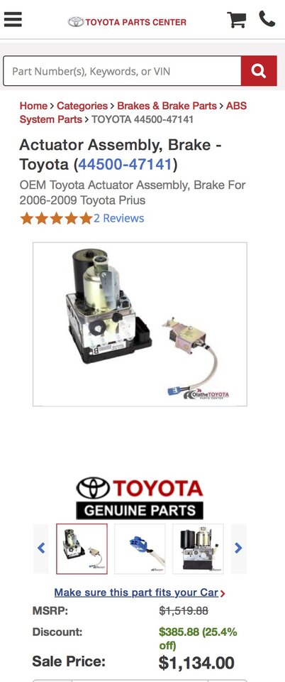

    The problem is you're showing a master cylinder, not the Gen 2 brake actuator assembly. The last time I looked, the actuator assembly was commonly available new from Toyo for 1100-1200 prior to any discounts
    Try using 44500-47141

    This is regular online price
    On sale last week it was around $750. Which illustrates Toyota markups. They can sell for half retail and still make money.

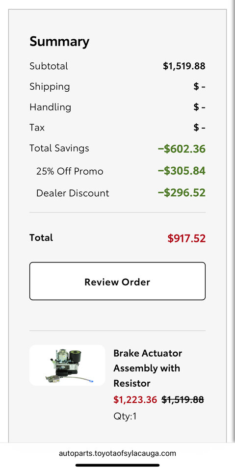

    I forgot to mention some discounts only show up in the cart during checkout.
    This one is $917 before tax
