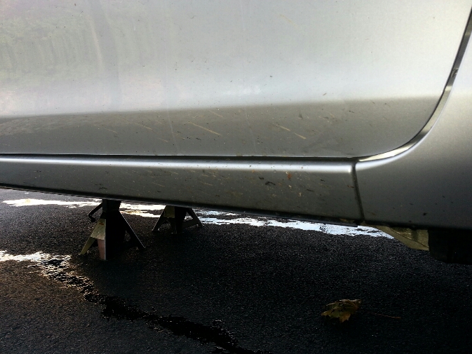

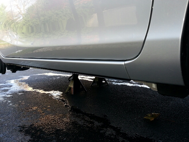

    Dryer sheet dipped in water, reapply wax.
