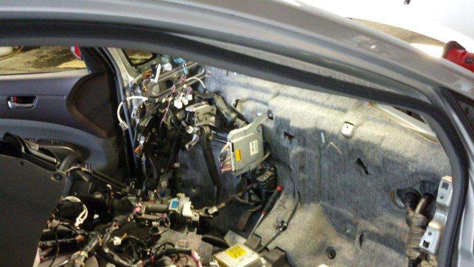

    No two ways about it, the blower housing is hard to remove. Effectively, the dash comes out:
    In Gen 1, there was a shortcut: a plastic bar that was part of the dash, running under the glove box, was cuttable (it was even marked where to cut it), so then you could get the blower housing out without doing the whole dash. The dealer sold a little replacement metal piece to screw in replacing the cut-out plastic piece (the places for the screw holes were already in the original dash).
    I don't know whether Gen 2 had a similar shortcut.
    I'm not sure the gray foam around the recirc intake is really a filter of any kind; I think it just helps the intake-select door seal off that opening when you want fresh and not recirc.
