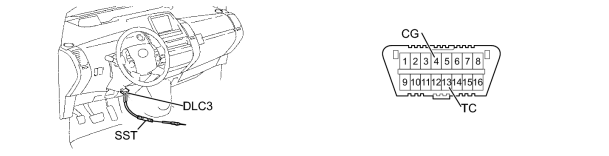

  19. numba41
    numba41 Junior Member
    May 3, 2014
    42
    Ashburn, VA
    The pictures below are for b) above.
    #19 numba41, Jun 2, 2014
