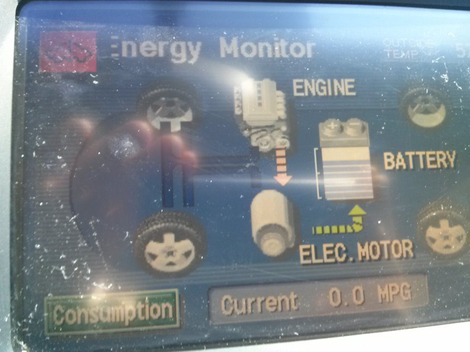

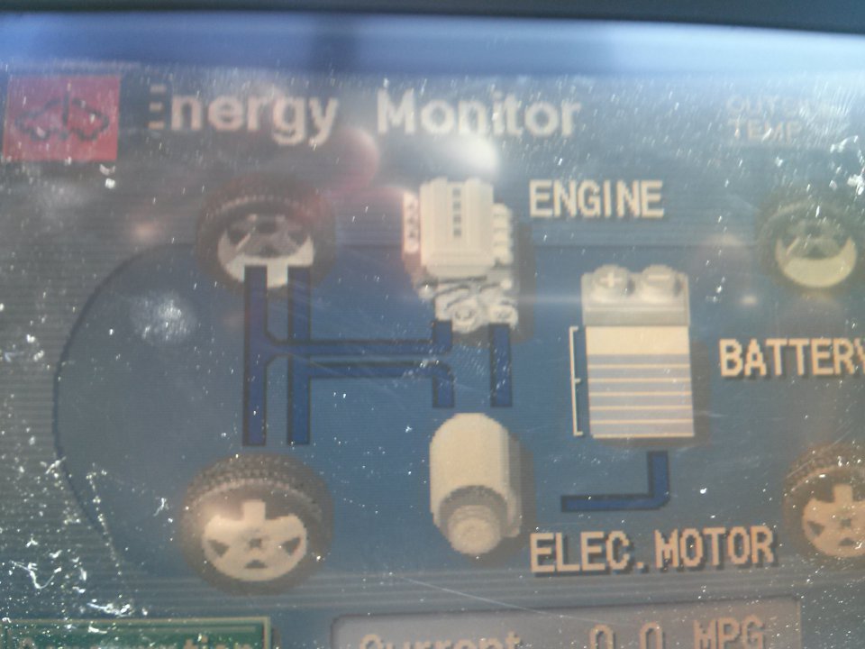

  8. Nandersizzle
    Nandersizzle New Member
    Apr 14, 2014
    Fayetteville, Arkansas
    The display looks like the first picture when I turn the car on. I can hear the gas engine running. Then it goes silent, and looks like the second. The same thing basically happens when I'm driving.

  10. JC91006
    JC91006 Senior Member
    Nov 10, 2013
    16,482
    8,400
    Los Angeles, CA
    The top left corner of the MFD display shows the "problem" symbol. You need to retrieve the codes and pinpoint your problem. You can't guess at it.

  12. Patrick Wong
    Patrick Wong DIY Enthusiast
    Mar 8, 2008
    18,200
    6,474
    Green Valley, AZ
    The photos in post #8 show that the hybrid vehicle warning icon has appeared in the upper left corner of the MFD. So there will be some DTC logged by the hybrid vehicle or traction battery ECUs. Hopefully the Autozone OBD-II code reader will be able to retrieve those.
