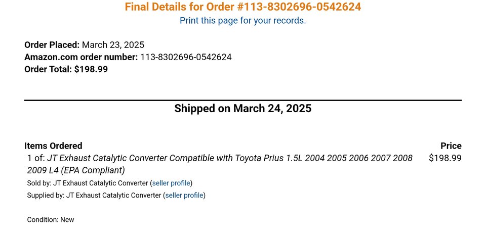

    After replacing the cat - where I used JT brand which was $200 on amazon compared to the $80-90 of the cheaper brands - the smell vastly improved.

  12. Shapechanger
    Shapechanger Junior Member
    Jan 18, 2009
    Portland
    Think I must've gotten a bad price in the fluctuations Amazon uses. Should have checked with camel camel camel. Napa wanted $583, so I hopped on Amazon to compare, and went with a mid grade. Or so I thought.
    Well it's cut and welded now so I guess it's staying. Shoot
