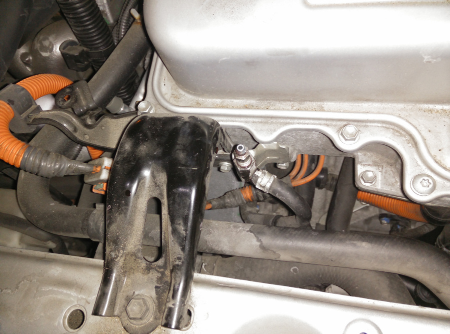

    When I first brought it back to the mechanic and asked about bleeding, he did something like that but on a different port. The port he used was not directly on the radiator and wasn't a hex socket. It was also on the driver's side, but up higher and in between the radiator and the hybrid system. It was a bolt with a hose barb on top of the bolt, as part of the bolt. (See photo I just took below; port is in center of photo.) He attached a hose to this, loosened the bolt, and ran the hose back to the reservoir. Coolant flowed though the hose, and a little coolant leaked around the bolt also. Was he using the wrong thing for bleeding?

    That's the bleeder for the inverter. If the valve that was replaced is linked to that system, it must be bleed too. that one you place a tube over it and to the inverter reservoir.

    Yeah, so I just opened up the bleeder on the radiator that the PDF you linked to pointed out , hit the power button twice, and all the coolant from the radiator reservoir disappeared... presumably into the radiator or some other part of the system. So they never bled that part of the sytem, only the inverter part. The problem is I don't have any coolant on hand to fix this, but I can take care of that tomorrow.
