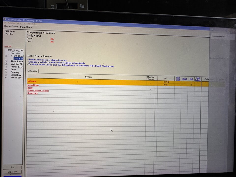

    In Techstream, click on Health Check and post a picture of the results.
  7. TechBill

    That health check isn't showing any current trouble codes, only historical ones.
    More concerning, that health check isn't even showing nearly enough ECUs. In a gen 2 there should be around a dozen. Somehow, Techstream here is not even talking to the engine or HV or brake/skid or transmission control ECUs, for example. (The transmission control ECU is the one that would have the codes related to P lock.)
    Somehow, that needs to be gotten to the bottom of.

    Was the car powered on to ready or ignition ON? I believe those 5 ecu's are the ones that will report even if the ignition is off.

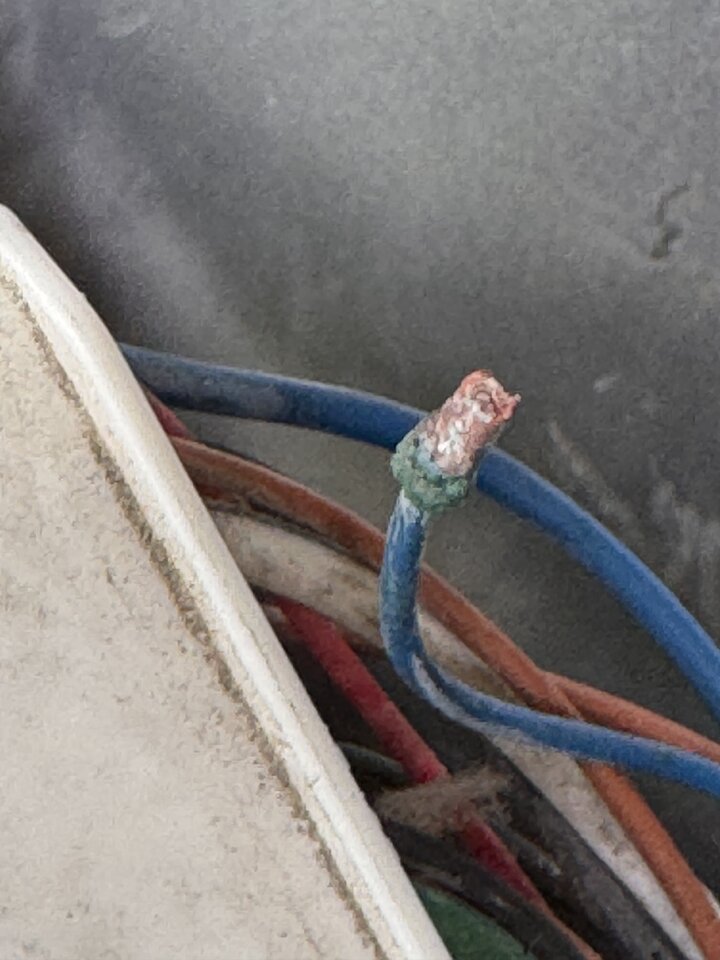

    I went ahead took fuse box apart again and found something interesting.
    Taking a break to post this photos.
