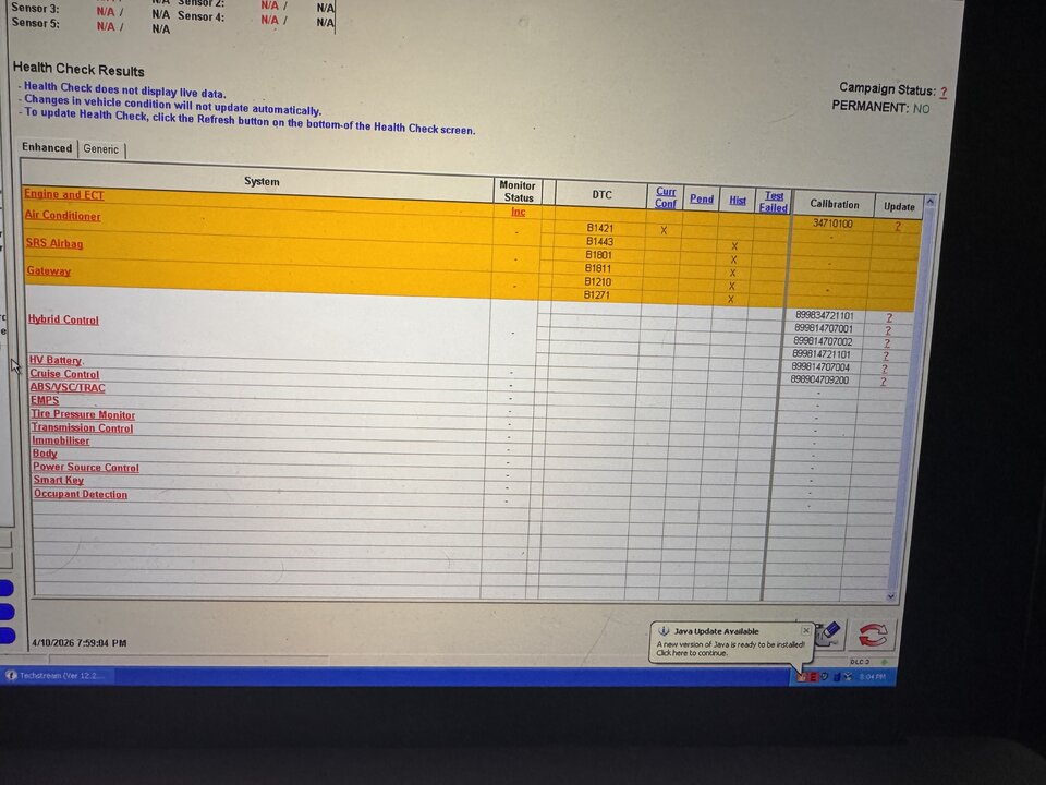

    After fixing two wires in fusebox .. I ran another scan with techstream. It showed up more devices ..

    Do the Techstream health check when the car is in READY, in drive, and the warning lights are turned on.

    I was going to do that after putting car back together but no more Red Triangle or P Lock. Check my previous post. If it comes back I am going plug the Techstream right away but so far drive fine now.
