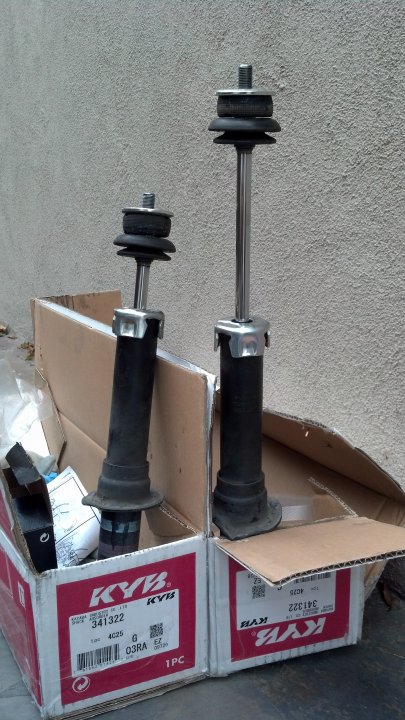

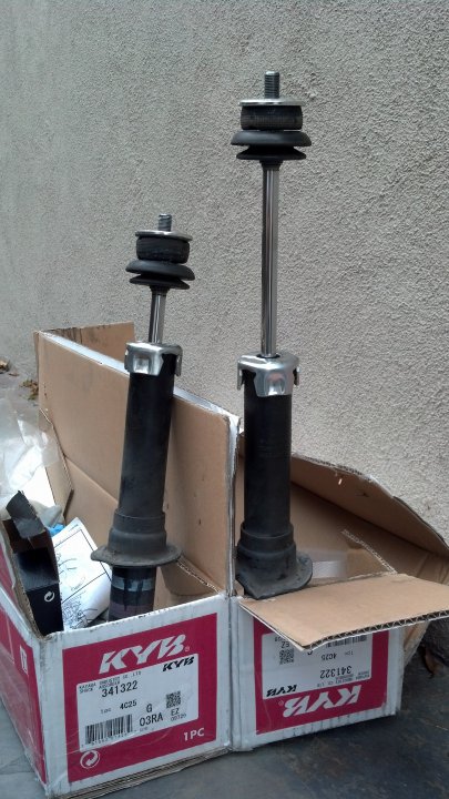

    What a difference 4 new struts make, after 127,000 miles on all 4 original struts. Long over due is an understatement.
    There were never any signs of leakage, bottoming out, and esp hopscotch marks on the tires. The lack of hopscotch marks surprised me the most; I would have expected to see this, after timing how long the strut rod's took, to go from full compression, to full extension.
    NEW rears: 7 seconds OLD rear: 3min 15sec for one. The other one, way longer, and stopped timing; eventually it did fully extend.
    This is what 3:15 looks like.

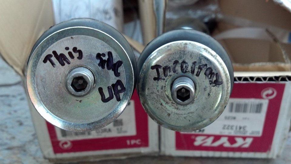

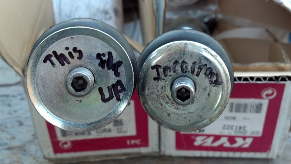

    Don't make my mistake in mounting the top washer. I didn't think it would make difference, until the whole strut assembly was mounted and the car on the ground. The rubber gets compressed a little bit more. I don't think it will make a huge difference.
