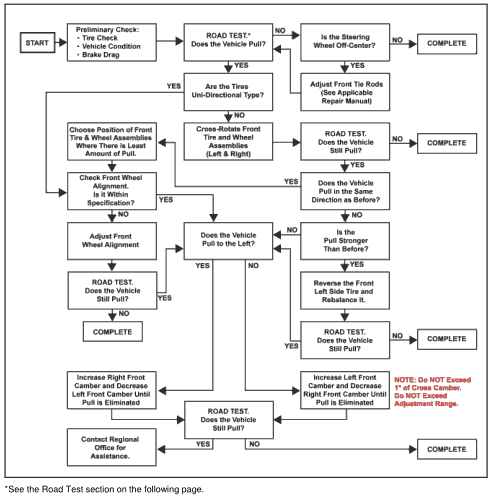

    Famous last words. :) The post linked in #2 above links a TSB that is 23 pages long. Here's one of the pages:
    AzWxGuy likes this.

    Oh, very nice. The diagnostic for steering wheel off-center would certainly result in some adjustments being made, and hopefully get things lined back up. It doesn't pull. The steering wheel just settles on a neutral input point slightly left of center. I should only have to bring the T-SB number and date to the dealer for them to do the checking. Thanks!
