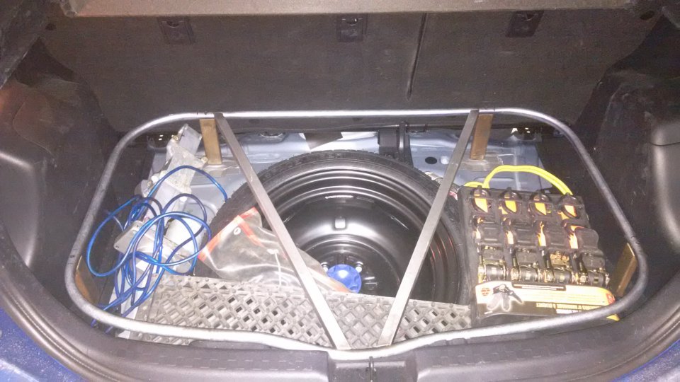

    Finally finished my trunk foam replacement.. Ended up being, as I mentioned in my last post, a length of 1/2" EMT electrical conduit bent by eye to roughly match the shape of the trunk well- so a rough D shape, straight on three sides and curved along the edge facing the rear of the car.
    The conduit has four legs that hold it up off the bottom of the well at the same level as the original foam forms. The two rear legs are 5-1/4" long and the two front side legs are 4-1/2" long. The top surface of each leg is concave to fit right along the conduit and prevent twisting, and the legs are fastened to the conduit by simply drilling a hole through the conduit and driving a 3" wood screw through the hole and into the leg, which is pre-drilled to prevent splitting.
    Two square aluminum tubes were placed in a V shape, and fastened to the conduit frame by gluing in a square dowel in the tube and like the legs above, simply drilling a hole through the conduit at an angle and driving a wood screw through the hole and into the dowel. In this case, the dowels were not drilled as any splitting would only serve to lock the dowel inside the square tube more tightly. The reason for the V shape was to clear the top edge of the spare tire while providing additional rigidity to the conduit and acting as a platform for the lid to sit on.

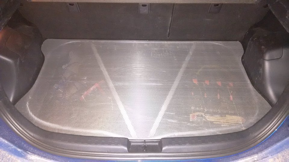

    The lid was perforated aluminum plate, 1/16th inch thick, 1/8" smaller on all edges than the carpet. The reason for the size reduction was to accommodate application of door edging all around the lid to prevent scratches on the plastic around the well and the back of the rear seats.. I was going to cut the lid in two and put in hinges so I'd have left and right compartments, but the lid as a whole worked just fine and I just left it all in one piece and didn't bother with hinges.

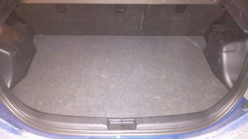

    The end result looks indistinguishable from the foam forms when the carpet is in place, but gives me a huge amount of hidden extra storage. The new shelf does not bounce, vibrate or make any noise, the removal of the foam has not increased or changed the cabin noise and the platform has has no problem supporting over 200 lb of feed bags without bending or warping..
