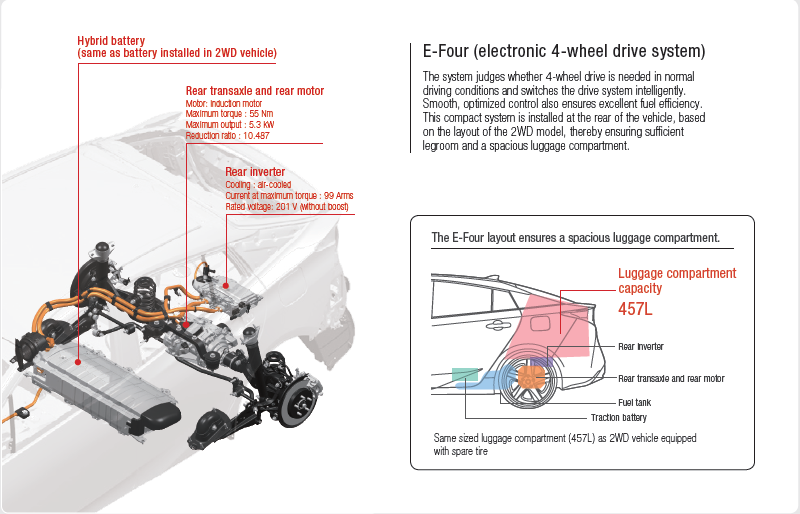

    Here are some graphics from Tideland Prius ...not too much detail. I am not thinking you have much space under the styrofoam.
    With spare (or E-Four AWD)
    457L = 16.1 cu. ft.
    Without spare:
