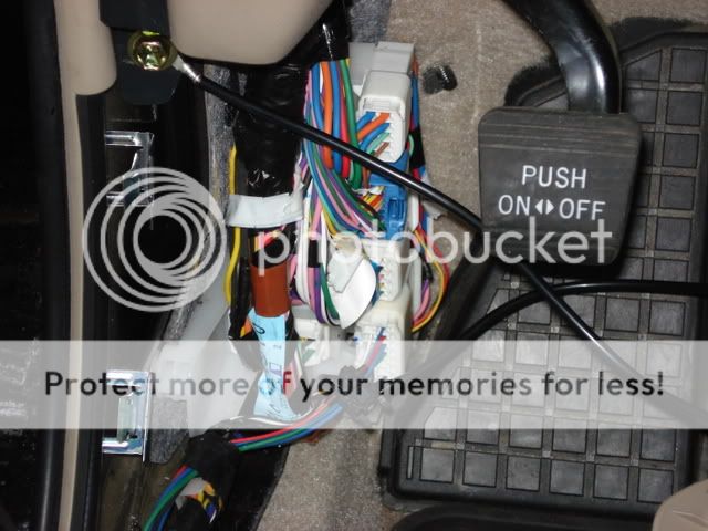

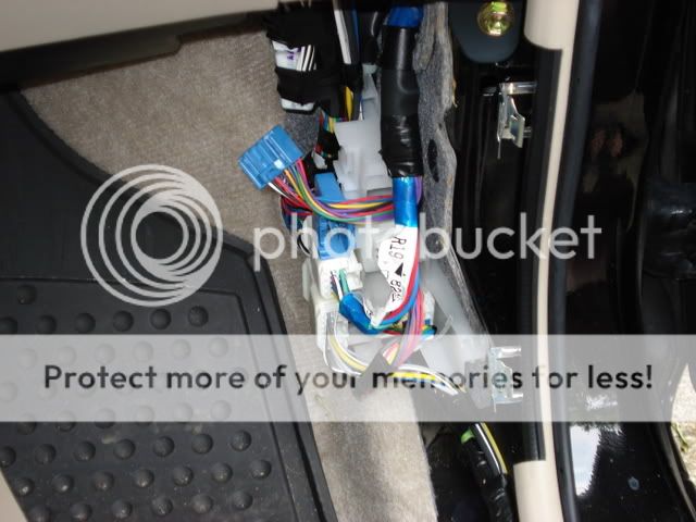

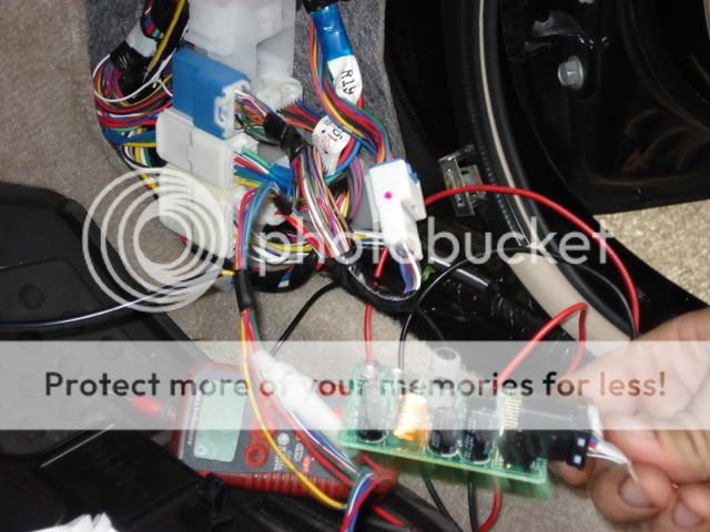

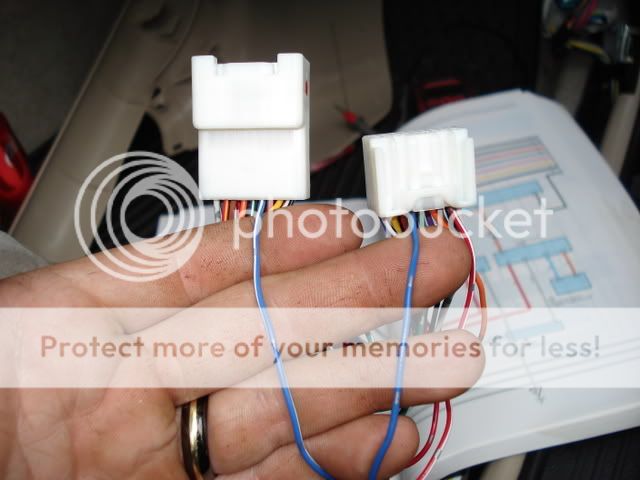

    DH finally had an afternoon to sit out in the car and tinker, so we did the reverse tilt module. And it works!
    First, many props to naterprius who was the first to try this, i believe, and who documented a whole lot of what he did, as well as bobc who was happy to collaborate with us in trying to figure it out, and stopped DH after he fried his own module. Also, the whole thing wouldn't have happened without car, who asked DH to figure this out and sent his module for testing/rewiring.

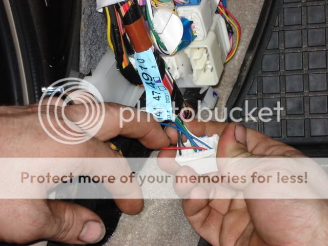

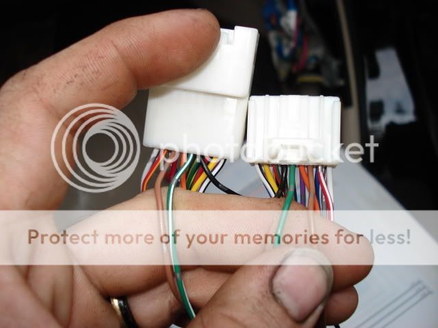

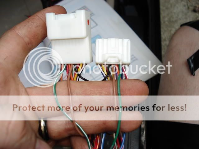

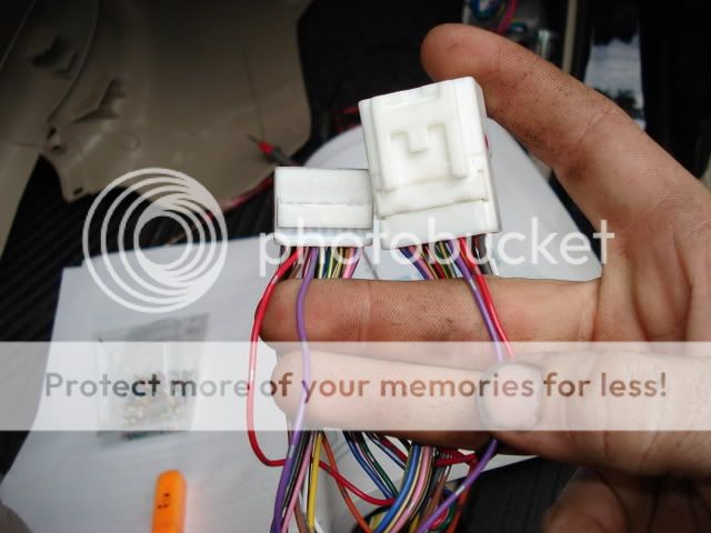

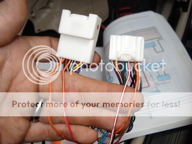

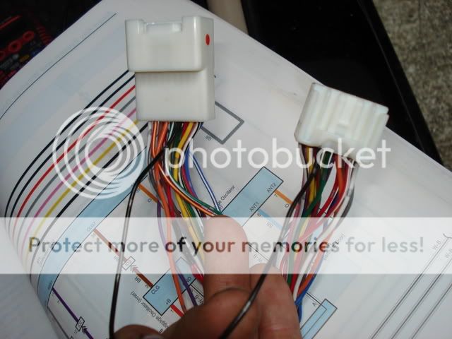

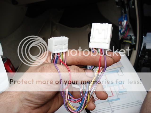

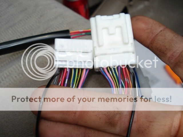

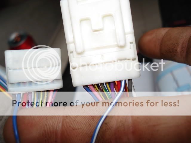

    Now. On to the instructions. DH looked at how naterprius and bobc went about it, and decided well hell. that's a crazy amount of work when there are exactly 4 wires that do anything and the rest are pass through. He rearranged the pins his own way and the rest was plug and play. So here we go...
    1. do your pin swaps in the harness.
    - battery +
    red wire, pin 13 on both input and output.
    swap with violet wire, pin 12.
    becomes
    -motor +
    red and white wire, input pin 4
    red and yellow wire, output pin 4
    swap with orange wire, pin 2.
    becomes
    -motor horizontal
    blue wire, input pin 6
    blue and white, output pin 6
    swap with black wire, pin 11.
    and
    become
    and
    -motor vertical
    green wire, input pin 5
    green and white wire, output pin 5
    swap with brown wire, pin 3.
    becomes
    plug into IL1 connector.
    2. ign switched power
    tap the power socket up front on the passenger side.
    3. reverse signal
    tap IF1 (on driver's side), red wire, pin 6. there is a long wire provided for this.
    4. ground
    use a ground screw or bolt.
    and tada! reverse tilt works.

    Bravo to your DH, Galaxee. Great pictures that tell the story.

    the first step in your instructions:
    "- battery +
    swap with violet wire, pin 12."
    What's running through the #12 pin in the car that supplies constant power? I wa looking for womething like this before I settled on the door courtesy light which has constant power (Red wire).

    <div class='quotetop'>QUOTE(galaxee @ Jul 11 2007, 01:47 PM) [snapback]476948[/snapback]</div>
    OK, the tilt module finally came from Sigma and I started to do the pin swaps. I pried up the connector's locking bar, but I can't seem to find the trick to get the little catch on the pin to release. On the mating side of the connector, there is a "T" shaped hole above each pin (the crossbar of the "T" is very thin, the vertical bar is very fat). I have been fiddling around with a very small jewler's screwdriver in that hole, but can't seem to find the release.
    I looked in the wiring repair manual, but there seems like several hundred connectors are listed and the pictures of releasing what they call the "lance" are not very clear.
    Any hints?
    Thanks!
    Tom

    <div class='quotetop'>QUOTE(Tom_06 @ Aug 24 2007, 01:39 PM) [snapback]501599[/snapback]</div>
    Use the metal spine of a common twist-tie. Like used on a bread-loaf bag. Strip away most of the paper and insert into hole in plug face. that will release the connector.

    <div class='quotetop'>QUOTE(9G-man @ Sep 6 2007, 05:11 AM) [snapback]507835[/snapback]</div>
    Got it, Thanks! Found out I was trying to move it in the wrong direction. You need to go from near the center towards the outside of the connector shell, not the other way around.
