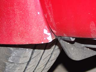

    I found a small issue with the skirts. Long time exposure to rocks will chip away at the paint in the front lower corner of each skirt.
    My solution to this small issue is to touch up the affected area with touch up paint then put a 3"x3" square piece of clear plastic over this area. Kind of like a small clear bra for the wheel skirt. I guess you would call it a clear thong. ;) :D
    When the temps warm up I will paint them and apply some left over clear bra material that I have laying around.
    I will report back when that project is finished.
    I will pass this tip along to Hybrid Effects to make a better product.

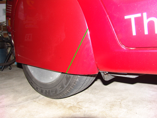

    Well I got done fixing the chipped areas on the skirts Thursday.
    What I did was clean them really well and applied 3 thick coats of touch up paint to the deep areas. Then I applied a coat of paint to the triangle area that was pitted. I did this all with the small brush and it looks just fine. You have to be really close to tell it was brushed on. Plus the protective 3M clear bra material helps hide it. I used some spare 3M clear bra material I had left over from a previous project so I cut out a large enough square to cover the affected area. Here are some pictures of the result. We will see how well this works out over the next year.
    You can just barely make out the 3M clear bra material in the corner.
    Here I have outlined where the edge of the clear bra is. The painted area is about a half inch in from the edge of the film. To anyone that has these wheel skirts I highly recomend covering at least this much of the corner. Most of the damage was at the very bottom but %99 of the pitting was with in this triangle area.
