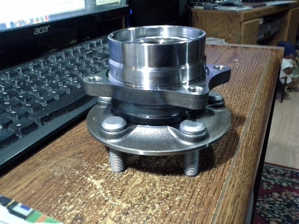

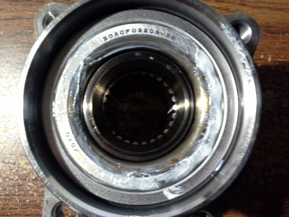

    They look like the "Good Stuff", made by Koyo. with the right part number. 3DACF038DB-2E
    I hope that they come out easily.

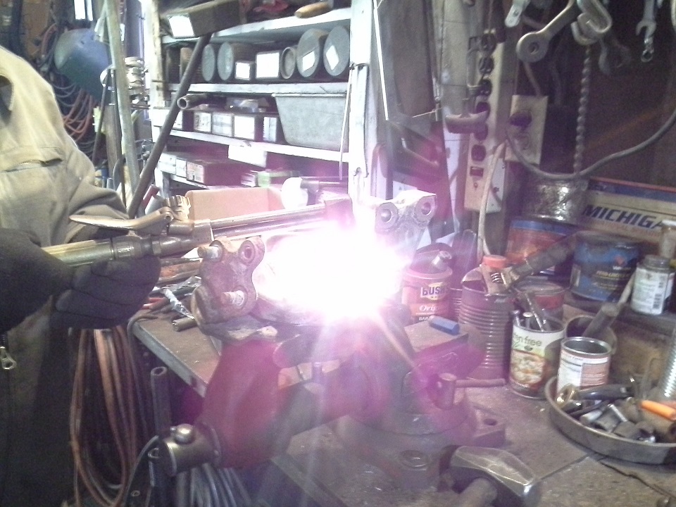

    I forgot about the 2 lower nuts under the lower ball joint. Steve, my friend, heated the nut with a an acetylene torch. That loosened he nut. Then we took out the knuckle over to the vice . We tried the beat it out with parts from my ball joint removal kit, a cylinder and cap to hit on. The joint wouldn't come loose.
    We got out with the Acetylene torch. Steve is an accomplished mechanic, and he heated the knuckle for about 3 minutes! The aluminum knuckle expands faster than the bearing and that what loosens it up. 3 whacks with a sledge hammer did the trick.

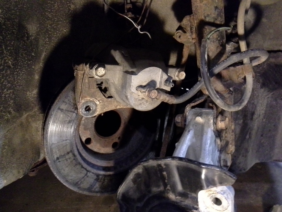

    Here is how I handled the rotor and caliper. I removed both together and wired them together and hung it on the spring. Picture below.
    This gave me one big advantage. You do not have to remove the battery negative cable! Now I could IG-on and turn the wheel right or left as needed. IG-on and turn the wheel and turn it off before the engine even turns on. All your settings stay intact. Since I had it loose before I now have to chicken dance for 2 settings,Reverse beep and seat belt beep. If I had thought of this sooner I would been good to go.
