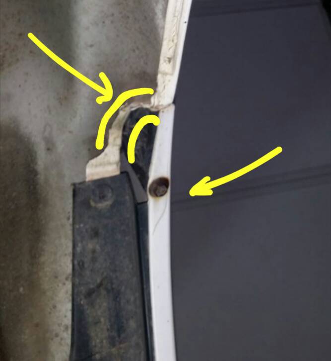

    When I was attempting to use 225/40R19 installed on a set of 19x7 45et I had to trim on the rear fender the metal fender tab screw and the highlighted metal on the body.
    With a 215/35R19 I didn't have to roll or trim anything in the rear.
    On the front I'd only roll them if you rub. I did have to roll the fronts with the 225/40R19 but not the 215/35R19. On both I needed to trim the front bumper tab and screw.
