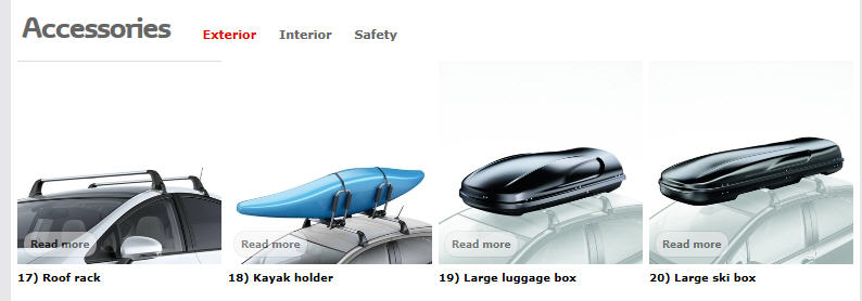

    I can tell you that roof top carriers can be used with the European Prius+/v with panoramic roof. Here are photos from a Toyota Europe website.

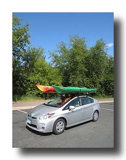

    My 2010 had a moonroof and carried 2 kayaks...
    Obviously, you can't open it then. But since the rack tower rest on the metal frame over the doors, it's basically a non-issue.
