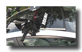

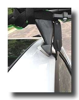

    It only takes me a few minutes, despite the solar.
    Here's thumbnails showing some detail...
    [​IMG] . [​IMG]
    [​IMG] . [​IMG]
    The larger versions, along with more photos, are available on webpage 137 of my album.
